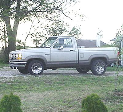

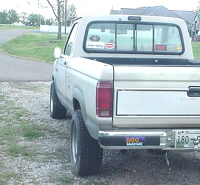

Let's see if I can do this - if it works I can comment further.
Okay. What you see there is an 89 Ranger, with skinny sidewall KUMHO tires on the front, mounted on 15 inch rims. This brought the height down and stopped a fender rubbing problem on dips
The back end required 2" lift blocks. I'd have used one inch, but they worked perfect. I have two sets for the rear - 235/60/15 Eagles, and 245/60/15 Mastercraft Avengers. The Eagles used to be on the front, but caused problems like I said.
What the heck, the rims were free... And you can see from the rear end shot, that I didn't go into pure overkill on the width. It's pretty much balanced
But the only way I can stuff the Eagles under the front is with two inch overstock spring coils, and an immediate alignment.

I hope your truck isn't 4wd Dutch. That tire size difference will really mess with your gear ratios.
I wouldn't dare do that with a 4X4, even if I thought I had different axles that would work. Nope, she's a street beastie.
