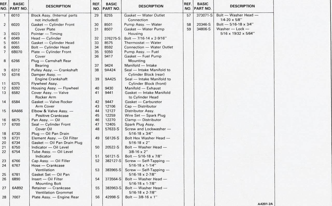

Just got my factory service manual today.YelloThumbUp
Its showing Block-gasket(6020)-Cylinder Front Cover(6B070)-Gasket(8507)-Water pump. In () is the basic part number out of the book.

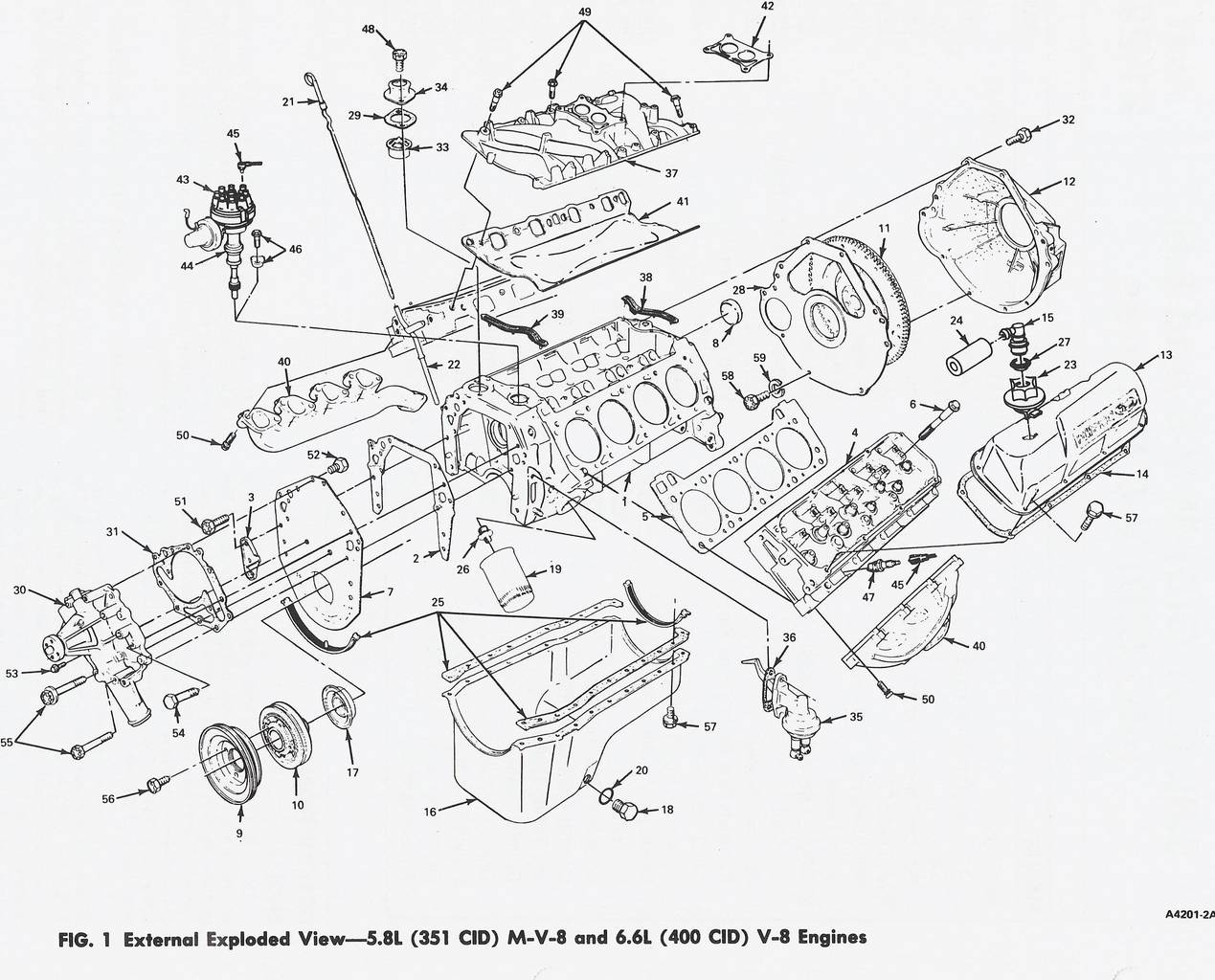

I looked up timing chain covers and found nothing close. It sits between the block and the water pump.
Take a look at the diagram you posted (post #10).
Now...compare it with this picture. Notice something missing?
See that "ear" sticking up with the crusty bolt hole...just to the right of the t/stat opening?
It's not part of the "Cylinder Block Cover Plate. So....what is it?
It's the waterpump's cover plate (D2SZ8508A) still attached to the engine.
It's not shown in the diagram....but it's obviously there.
