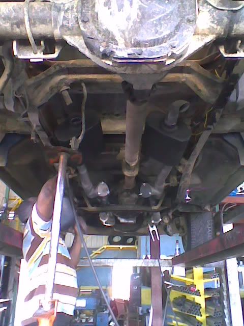

ohh ok ok ! but my cut outs are not directly behind the headers but a little farther..
nway i understand now btw what is a symptom of a burned valve??
here you can see the exhuast it was the day at the muffler shop
