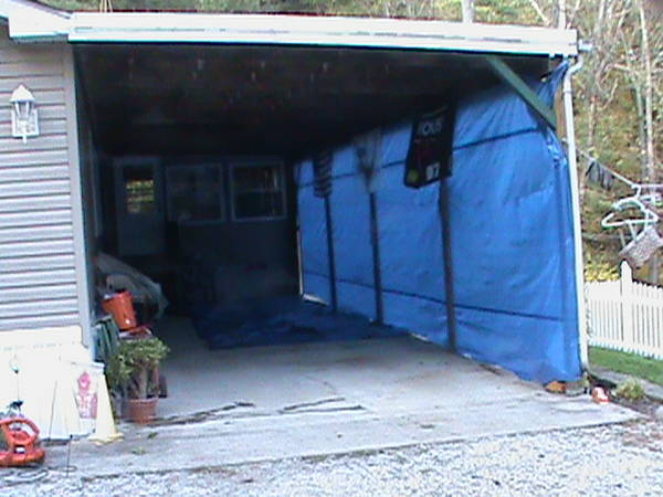

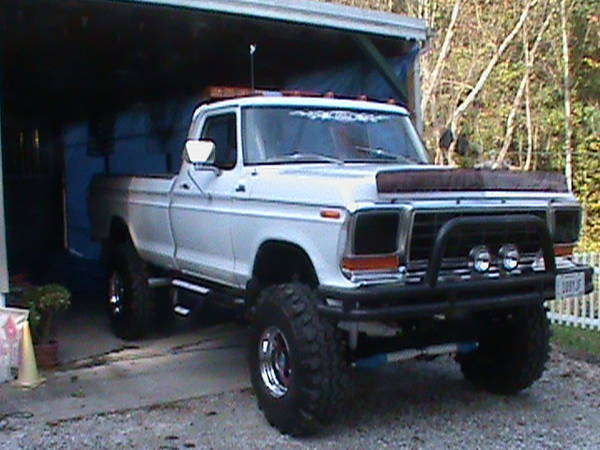

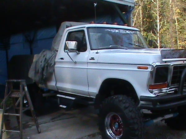

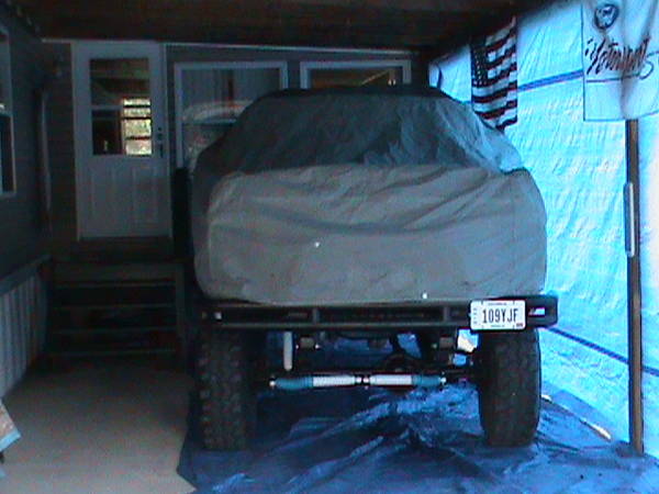

Today we prepped the carport and truck for a long winters nap.....
one final staredown...Damn i hate this time of yr.......
Positioning the cover......
Goodnight Sweetheart.....Goodnight.....see you in the spring...

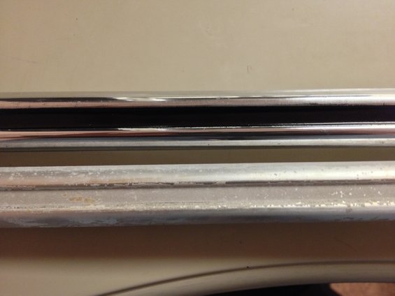

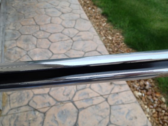

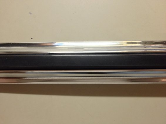

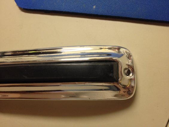

Seeing as how these aren't reproduced I turned into a trim restoration guy.
From this:
To this:
Lower tu-tone trim.

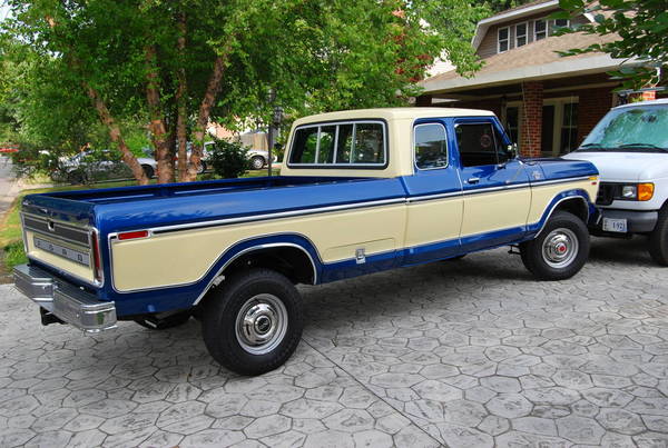

Big Jim F150
73-79 Ford Trucks Rock

Scott , could you tell how you got the aluminum that shiny ? I've got one piece I need to deal with.
I like the pattern on your driveway.
First I used stripper to get rid of the camo paint. I then used Easy Off in a spray can. If I were to do more I would definitely go with a Lye/water mixture. I think it would be less harsh on the aluminum. I then wet sanded the areas that needed it with 1000 grit. Then took it over to my bench grinder converted to a polisher and worked some magic to get it to shine. I'm going to give it a coat of clear enamel from a spray can and see how it looks. If the results aren't up to par I'll try this: http://api.viglink.com/api/click?fo...PC_p_45.html&jsonp=vglnk_jsonp_13821891200437
That is my rear sidewalk Mark. It is all part of the pool area out back. I couldn't afford to do my driveway in concrete. Your drive looks great!

LOL i was kidding man, but it does look awesome. i've been searching the forums on how to do it for a while now, like you said very labor intensive. i wonder if anyone is making these in the steel version like our grill shells are now being made...?
Thanks, yeah I knew you were kidding. It is a lot of work. I haven't seen any in chrome steel yet.

That glisten pc looks like some good stuff. Especially sticking to polished aluminum.
