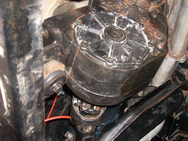

I'm pretty sure my trans is out, here is what's going on:
I took the truck out for a drive the other day, I got about 1/2 mile and I heard two slight clunks from either the trans or t-case, directly after this noise, the rear end locked up for a second. The trans would then only pull in 1st gear, I could get it to stay in 2nd for a bit and then it would just start slipping, causing me to have to limp home in 1st. The transmission thew out about 2 qts of fluid on the way home (about a 1/2 - 3/4 mile) Trans fluid was everywhere, the headers even caught on fire from the burning fluid!
The ATF fluid smells burnt on the dipstick & I loosened up the plug on the transmission pan (aftermarket pan) & it looks to have some black coloration & that bad burnt smell.
The crazy thing is, the truck will drive fine in the yard, but once I drive it out on the road it does the same as above after it goes threw the gears.
I've drained the differentials & they both look clean, no shavings. No excessive slop in the u-joints or at the rear of the diffs.
I've also drained the t-case, the fluid was clean, no shavings. no weird fluid smells, the chain had some slop with the t-case in neutral, but that may be normal.
I will drop the trans pan this week, I've just never heard of a trans going out & causing the rear end to lock up for a bit. From the smell of the ATF fluid & checking everything else, I'm leaning towards a bad trans.
