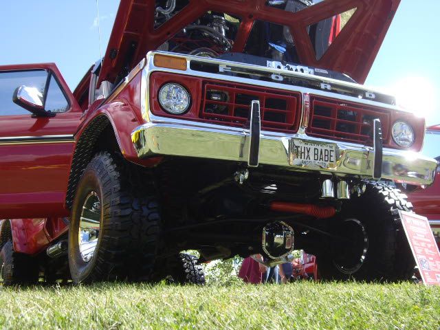

Hey Ben, these are for oil, right? The 77 has a system like this set up which is why the 2 chrome covers that stick out just below the front bumper (relocated and with dual filtration),
But you wouldn't use this system for the tranny, right?
Like I said in my first post...a filter doesn't care what kind of oil is going through it...and oil doesn't care what kind of filter it's going through. It'll also add an extra half quart or so of fluid to the system...which is never a bad thing.
^^^Ahhhh....ok, I didn't know you can relocate the tranny fluid like you can with oil.
