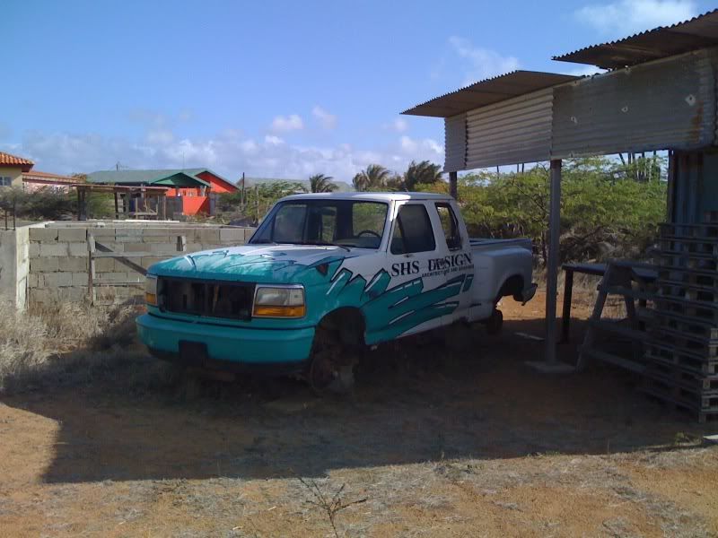

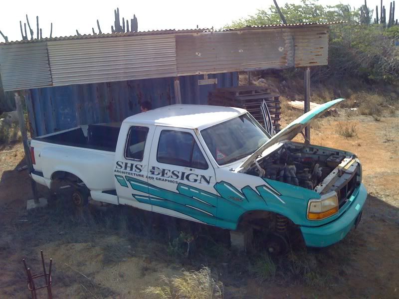

sup i got some new pics and better pics of the truck

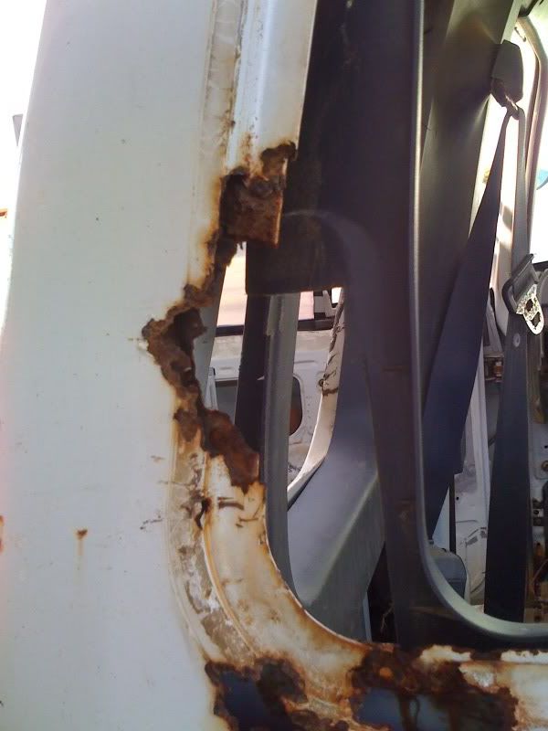

the body overall is good the only rust its got its on the rear window frame
and a little under the doors overall its good

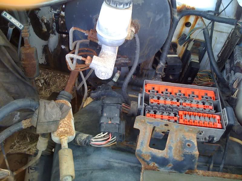

the owner didnt know what he was talking about actually the truck is an 93 not an 92 like he said.. it has the complete harnass but of an l6 engine.. the l6 even has headers.. any one interested? 250 bucks.. complete engine with harnas and ECU PM me
i will use a complete stang harnass and build an computer box on the passenger,since the stang harnass ecu is on the passenger side..
, side and i wont mess with the harnass just chek for bad wires and install..

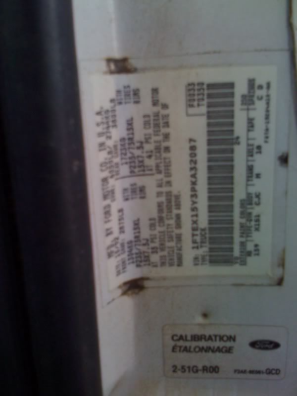

any one can give me more info about the truck Vin?
1FTEX15Y3PKA32087
Rear window rust

You've got a lot of work ahead of you my friend... I wish you nothing but good luck, lol.
As for the VIN...
VIN: 1FTEX15Y3PKA32087
World Manufacturer Identifier - 1st, 2nd, 3rd Positions
VIN Code: 1FT
Assembly Country: USA
Make: Ford
Body Style: Pickup
Restraint System Type (Passenger Cars) or Brake Type and GVWR Class
(Trucks and Vans) - 4th Position
VIN Code: E
Brake System: HYDRAULIC
GVWR Class: Class E
GVWR Range: 6,001 - 7,000 Pounds
Line,Series Body Type - 5th, 6th, 7th Positions
VIN Code: X15
Vehicle Line: F-150
Series: XL
Body Type: SUPER
Vehicle Type: Truck/SUV
Engine Type - 8th Position
VIN Code: Y
Engine: 4.9 L
Cylinders: 6
Fuel: Gasoline
Horsepower: 145 - 150 HORSEPOWER
Model Year - 10th Position
VIN Code: P
Model Year: 1993
Assembly Plant - 11th Position
VIN Code: K
Assembly Plant: KANSAS CITY: CLAYCOMO, MO
Production Sequence Number - 12th - 17th
VIN Code: A32087
Prod Sequence Number A32087
I, uh, wouldn't sell the F-250 too fast if you need transportation...that white truck is gonna take a lotta work and time to get roadworthy.
Good luck...should be sweet when you get done with it!

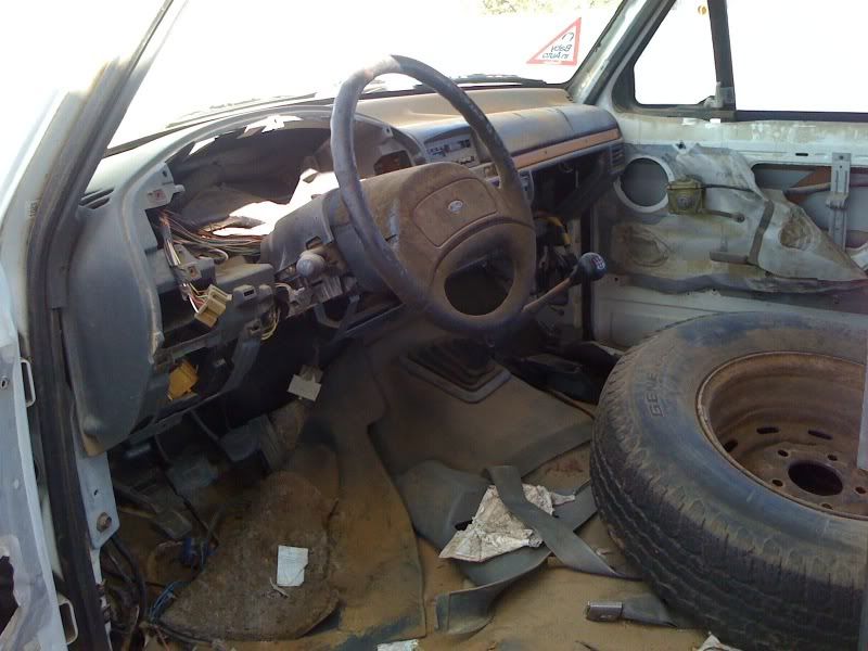

Wow, that truck is torn up. What are your plans for the interior?
i have all the seats and accesories, only thing i need is the dash cluster..

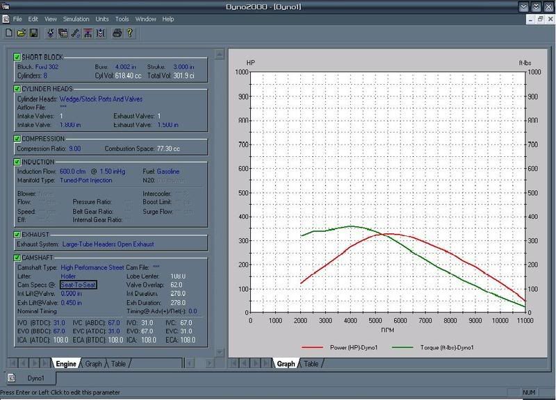

if I remember and I'm not passed out drunk i'll throw it onto my desktop dyno.....I think I was actually looking at that cam...what other engine specs can u give me?
i came up with this
im gonna run the engine let it break in first with the stock cam.. than swap the cam.. btw is it a roller block?

And.. you need to use the actual flow data for the GT40 heads.. not some GM based wedge profile in DesktopDyno.. if you want accurate predictions. I get just under 300hp with that cam when using the GT40 headflow data. But that cam is a flat tappet so you'll want to use a roller cam.

then wich cam is a good cam? i dont want BIG cam that idles very rough just a little lopey and good power for everyday driving..
here is the list:
