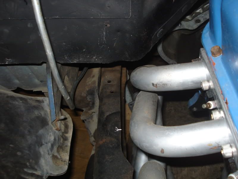

the old man has been bugging me all day about this!! ( fuel lines/heat/headers )
he says that the fuel line is too close to the headers and its unsafe!.. i think its just fine but i still wanna put some kind of heat cover around that part...
the distance is 5 inch

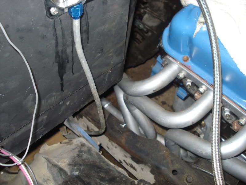

dont worry about the dripping fuel look on the regulator.. thats old.. it doesnt leak anymore
nway what do you think????
btw i still have to bend it to make it nicer looking now its just sitting there
the old man wants to insure me tomorrow so if something happens he well be fixed :guns: haha!:rolling laugh:
I was going to suggest wrapping the headers but it would probably be easiest to do that by taking them off and I'm guessing you don't want to do that... I suppose you could wrap the fuel line but it makes more sense to wrap the heat source.

You could put a heat shield bolted to the frame to dissipate the heat. Doesn't have to be anything fancy, just something to get between the headers and the fuel line. Personally, though, I wouldn't get too excited, as that is a pretty fair distance away. The factory routes it inside the frame rail right past there. You could put a little pipe insulation around the fuel line if you are concerned about vapor lock, solves the problem quite nicely.( Been there, done that.)

I wouldn't say it's too close!!!
Looks fine to me!!!

Looks good on the distance but vapor lock would be my concern.....even then it still looks good...I'm just picky enough to wanna insulate it anyways.

Looks Ok to me distance wise.
I would put a few hold down clamps on the line so it doesn't vibrate and loosen the fittings or rub a hole in the line.
Looks ok to me, but you might want to insulate it anyway. Just a little added insurance so you don't have to worry :)

Get some header wrap. Will help with that problem and will help your under hood temps too, less heat under the hood, the less heat you draw in the intake, colder air is denser and as we know denser air is more power...
thanks!! i will put a few clamps in there and insulate it with something!

I think it will be fine. If you want some cheap insulation for the line, you can try to find some of the stuff that was used on EGR tubes. I have it on my Ranger because I have nylon lines about 3" from the exhaust, but I haven't had it long enough to know how well it works. A small sheet metal shield would work well also.

You should be safe but to prevent vapour lock id consiter putting some sort of heat sheath over the fuel line. On my Powerstroke there is about 5" of space between the exhuast manafold and fuel lines... and i have seen the exhaust gas temp guage at over 2300deg, no problems at all.
