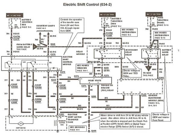

The brown wire mod is for temporary 2wd, if you keep it unplugged you can burn out the transfer case

Not necessarily. I don't think we're tracking here- that Explorer is an ALL-WHEEL-DRIVE, not a 4X4. There is no 2WD setting, just over-rides for the Automatic 4X4 (equal power to both axles) and a 4Lo setting.
so how would I definitively check to know if I have a bad xfer case or something else going wrong, im really close to taking it to the tranny shop and throwing lots of money at them even though it goes against everything i believe in. seems like there has to be a way to jump a wire, disconnect a wire, something to tell the xfer case to go to 2wd....am i wrong in that, I figured disconnecting the brown wire would do it...apprently not.
any other ideas, at my wits end, thought I had it licked today when I tried the brown wire
thanks for all the help
Just from reading the posts here it seems like you don't have a 2wd option, so maybe nothing is actually wrong. Vince's diagram confuses me this late at night so I can't help try to explain it. Since you only have auto, 4 hi, and 4 lo then it pretty much sounds like it is all wheel drive.

Does your 4x4 shift knob look like THIS?
Auto - 4Hi - 4Lo
If so, you can't have true 2WD
2WD - 4Hi - 4Lo
If so, then you could have a faulty shift motor if you are stuck in 4x4.
Or does your radio bezel look like this, with no knob
If so, then your truck is AWD (or 2wd :wasntme: ) and can't be shifted into 2wd mode....
Auto - 4Hi - 4Lo
2WD - 4Hi - 4Lo
You sure the third pic isn't of a 2WD? Pretty sure it is.
The way it was explained to us salesguys, the 4X4 position only exists to lock the system into equal power to both axles, for deep snow or glare-ice conditions. The rest of the time, the system decides how much power to divvy up between the front and the back. 4Lo same story, except for the 2:1 reduction ration. Affectionately known as the "boat ramp position."
