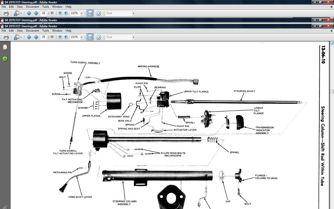

These of any help?

Duncan posted the 78 version

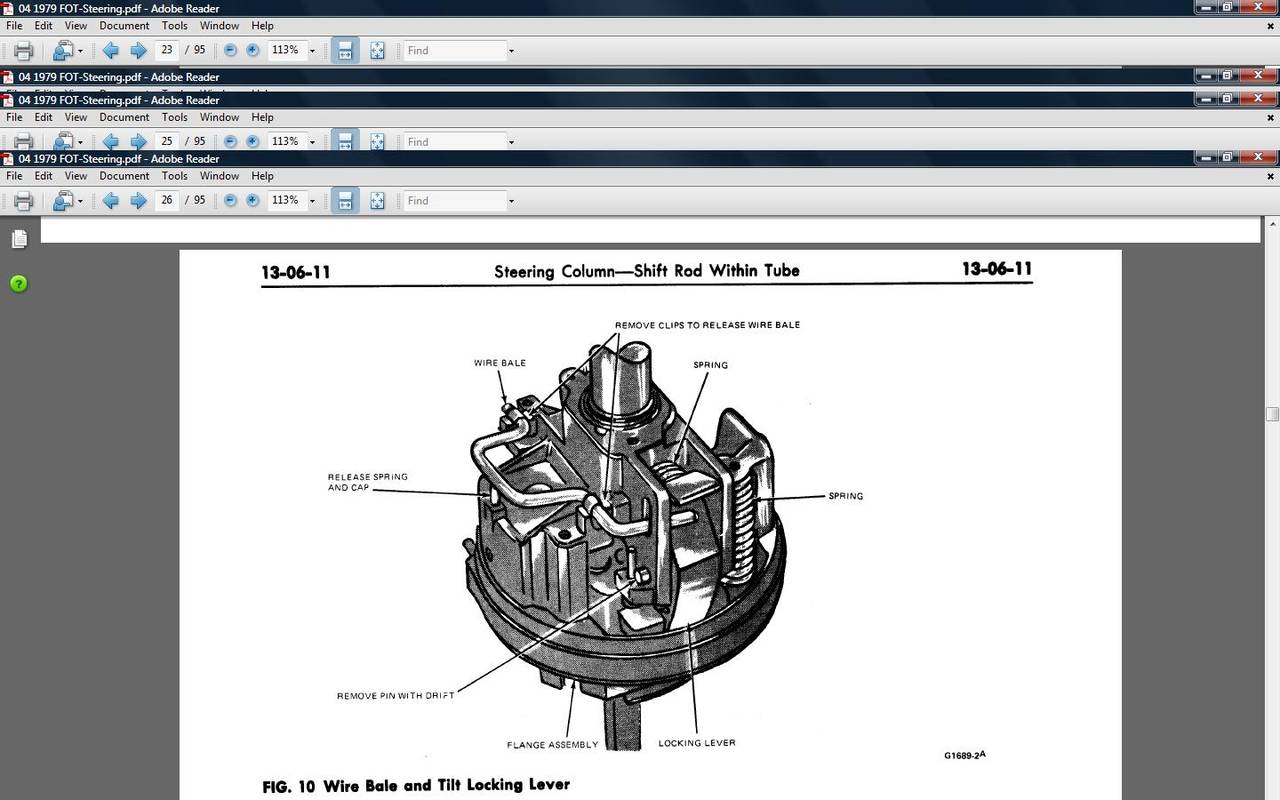

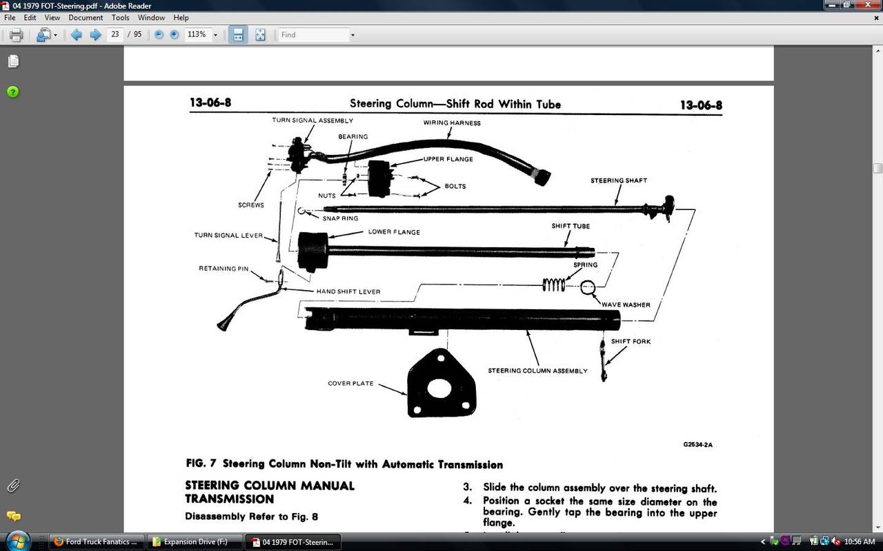

this should help
Yes - I have the Non-Tilt Column so that illustration was helpful.
Thanks!
That's because the Tilt column wasn't available until 78
