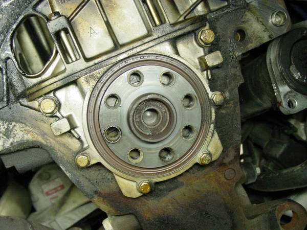

Alright, remember I'm new on this, by pilot bearing, which part of the vehicle are we talking about???
Pilot Bearing fits into the crankshaft like this
One thing i would suggest is that if/when you pull out the gearbox you take the flywheel down to a reputable engineering workshop and have them check for any "high" spots on the flywheel which they can "true up" on a good lathe and also get them to balance it as well.
I tend to agree with Alvin when he is saying that a misalignment problem with your bellhousing can cause this and a roller bearing such as shown in the pic above is a lot more forgiving than the standard solid bushing that i imagine is fitted in the back of your crankshaft at present.
Cheers Mark

That is the back of the engine in the picture with the flywheel removed, right? And the roller bearing is smack dab in the middle?
Prepare for moron question.... Wait for it.....
Yep bearing is smack in the middle.
Cheers Mark
on the back of the engine behind the flywheel:headbang:
:hehehm: Yep welcome to skinned knuckles and a new opportunity to string together curses in ways you never thought of before.
