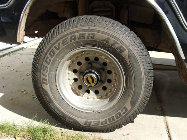

Got my new hubs today in the mail!
Yaaaayyyyyy!
Those are PURDY!
The premium hubs turn almost all the way around to engage. The regular hubs turn only about 90 deg to engage. I've had my premium hubs for about 2 years and really like them. It took me a little while to get used to turning the knob so far, but it is an improvement.
Good luck with the install!

Here's mine
Very nice!
Yeah I read about the longer turns. Seems it would be more secure that way...also, caps are metal vs plastic.
New hubs are one.....GOODBYE AUTO HUBS FOREVER! On the Bronco anyways! :)
