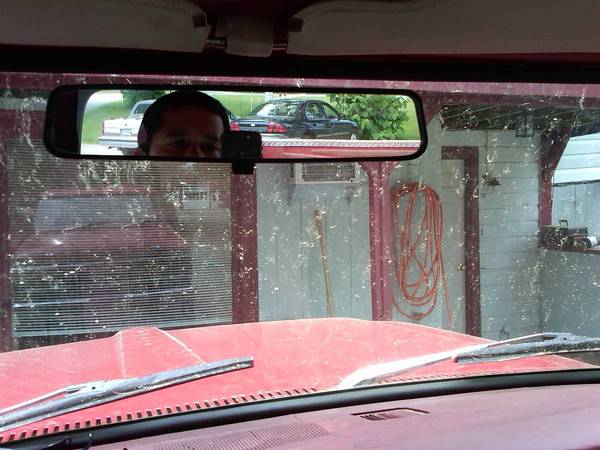

The mirror finally stayed on and I tried with everything I had to pull it off and couldn't!
Thanks again everyone for your help.....I think the main problem, besides starting off with cheap VIP crap, is that I didn't clean the window good enough, if there's one thing I can take away from this product....also using quality products....the local parts store had the Permatex brand mentioned earlier and that looked like it did the trick. I used paint thinner to clean the window.
