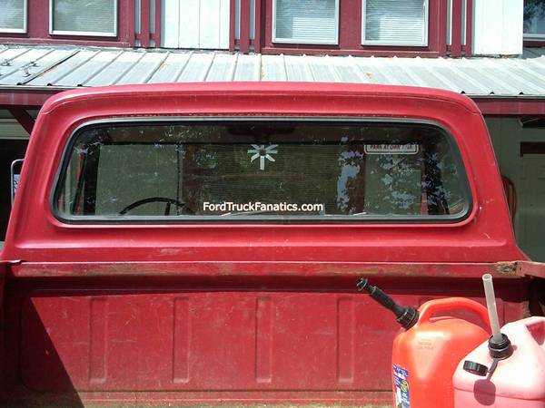

Can you see the tape on the plastic clip:
Oh yeah, I couldn't find the FTF Sticker thread that was hear a few days ago, but check out my sticker in the pic above...
