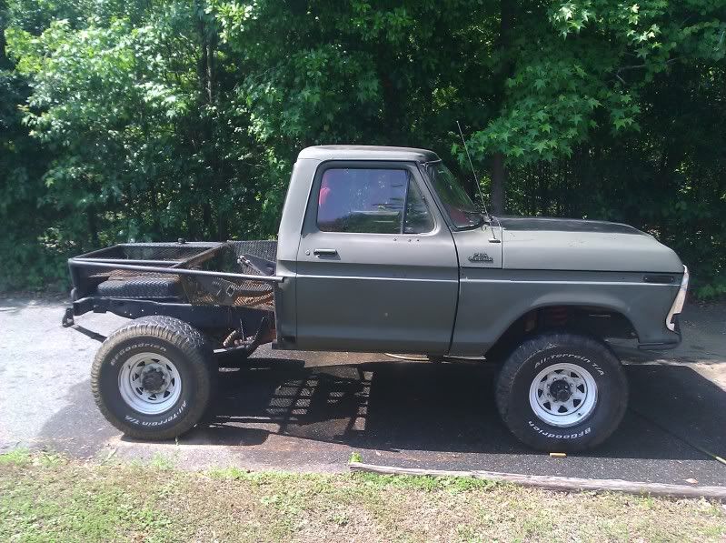

Anybody have any ideas as far as ripping the bed off and making it a flatbed? Im thinking about making it a dune truck/toy now, and the box is pretty rotted out, how hard is it to shorten the frame and make it a 250 shortbox? I'd rather do that than a flatbed...

Something like this perhaps?
