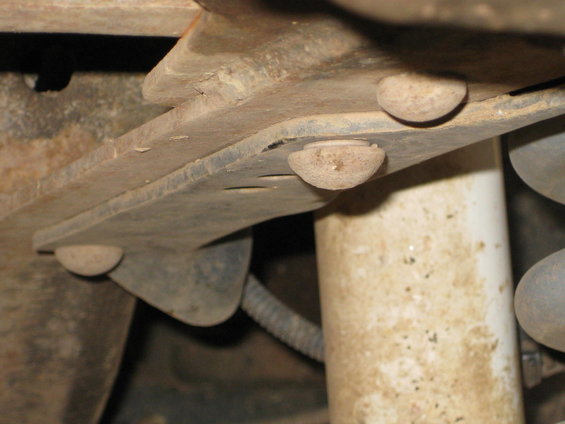

Look where your steering box bolts up to the frame. At times, cracks can develop causing these noises (especially when turning). Look at all the crossmember rivets too. There will be obvious marks if any rivets are loose.

On my 94, I had to weld all of the crossmembers. Every damn rivet had loosened up over the years.

Mine wasn't very obvious until I started looking for it. At the edges of the cross members, I could see tiny marks, just enough movement to make the popping noises I was having.

Yeah chris, this one's a lot better than the UC one, I'll see if I can post up a pic of that loose rivet I found, It was oblately obvious looking at it but I had been searching for the cause of that clunk forever so maybe it's not quite that obvious.
I think I'll lay some really small tack welds along some of the riveted areas and so for a drive and slam on the brakes while turning. If the clunk goes away or the tack's break I found my answer. Bolts!
