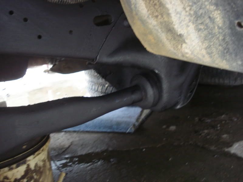

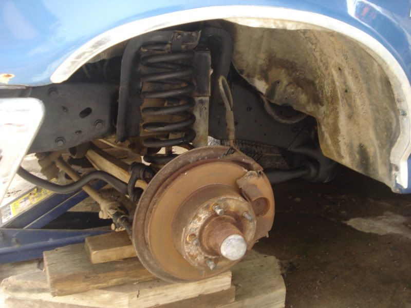

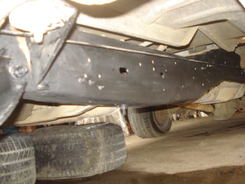

here i started to grind to take off the rust of the chasis and then started to painted it with undercoating.. but it started to rain so i didnt finish..

Nice. How are you cleaning the frame? Wire brush on a sander/grinder? or?
Those twisted wire cups work pretty well on a small grinder. They even have tiny ones that work in a drill (for tight spots).
Just wear long sleeves and a face shield. They sling wires out at a high rate of speed.

Looks like the "Body Schutz" that 3M makes. No clue how that is pronounced. :redface:
It is a rubberized undercoating (the 3M stuff).
http://www.goferauto.com/prfo3mboscru.html

dunno.. but i try to remove almost all surface rust before i apply paint..
why ?
the one i have is has also been sitting for about 4 years my brother used it on his prev project.. its still good.. the one i have is writtin in german
Well I ask because I know that once you have surface rust its almost impossible to COMPLETELY get rid of it. There can still be slight traces and those slight traces can manifest and make the paint bubble. That's why I want to use a paint that has rust inhibitors like Por-15 or Eastwoods.

I have no experience with the undercoating stuff.
Media blasting and sealing everything with epoxy primer and top coating with SS or B/C is a better way, but....not many people are going to go that route on a driver. Takes too much time to take it all apart. Some show vehicles are even powder coated. :suspicious:
Mine will never be done right. The eastwoods stuff is working ok for now, but it will eventually rust again. Nothing stops rust permanently
Either way...it is better than what it was without being cleaned up and coated. Jurgen's is too. I would imagine the salt air down there is rough on any steel after a while.
Budget, time, and physical ability all come into play as well. At least for most of us.
I've been doing an undercarriage restoration of my new car, sandblasting or wire wheeling everything and then coating it in POR15... no worries after that.
ahh ok ok .. i dunno bout that paint so ill keep grinding and painting with this one :)
i went to ask my big brother.. he said you can paint over surface rust with it... he painted his blazer frame about 3 years ago and it still looks good :)
