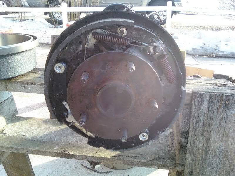

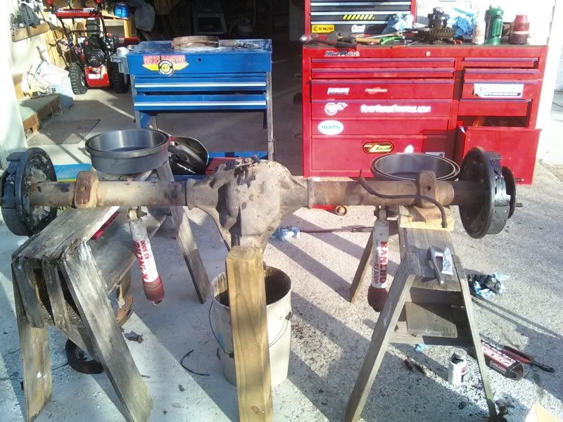

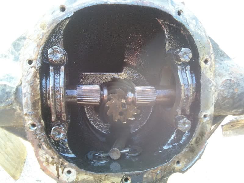

well i started work on the axle yesterday. i put it on saw horses and went to town.i took it all apart and started to inspect the axle. the housing is in great condition. the axle shafts seem to been in good condition from what ive looked at. the backing plates are brand new so i dont need to replace those! woot! the diff cover is also in great condition. i replaced the entire brake system on the axle yesterday. once i was done that i took out the carrier. now when the axle was together when i bought it i had my friend hold down one axle shaft and i spun the other shaft. it was wicked hard but i started to spin the other shaft while the one my friend was holding the other one. does this mean the clutches are good? im honestly not sure because i dont have that much experience with posi axles. that being said i also gave chris a call(skandocious) to see if he knew anything about the clutches in a posi. we talked for a bit on the phone and we pretty much came to the conclusion that i should replace the clutches in the posi. on a side note he doesnt have a weird hippie accent ;) i took a look at my ring gear.....and found a chip in the gear.........im not too happy about it but oh well. looks like im going to be getting a new ring and pinion(for the THIRD time now from chris..haha)

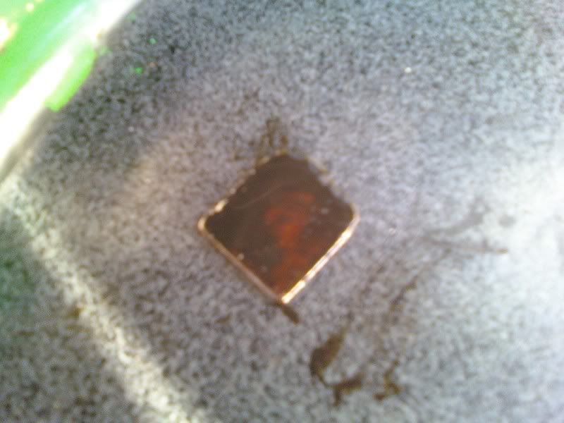

and here is where i wasnt happy........there is a chip in one of the teeth on the ring gear. AND i found 2(two) of these plate chips........on the bottom of the pumpkin
