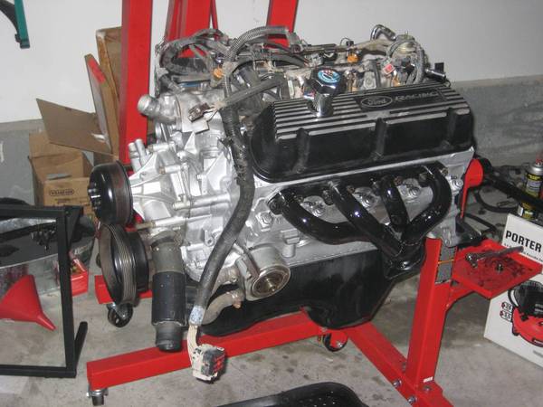

If you hot tanked the block, you will want some kind of coating or it will be rusty within a month. Otherwise, looking good. I have actually had decent luck with paint staying in general, around the exhaust of course gets a bit warmed... I understand your position though, as it is tiresome sometimes to get every bit of grease off, even tanked there will be a little. There likely is some on the block from doing the assembly now, but brake cleaner generally will take care of that.
Looks good, Ryan! I would like to try an engine rebuild someday. But, at 2-3K a year mileage, it might be a while.
Alright, Chris. I put a little paint on it for you. I still need to do another coat of black on the oil pan, but this is for you. :rofl:
Looks good Ryan!

Looking good so far Ryan. Now get it in the truck already.

Thanks guys!
I'm working on getting it back in the truck as fast as I can. This weekend I also swapped the huge main wiring harness in the truck. There are a few problems with the harness I purchased.

Did the headers come with a black paint, or did you paint them? Looks very nice. Is this your first rebuild?
Those headers came with a crappy black paint on them. I used them for a few years and the rusted almost immediately. I sanded them down and spray painted it with a super high temperature ceramic header paint. Hopefully this holds up.
