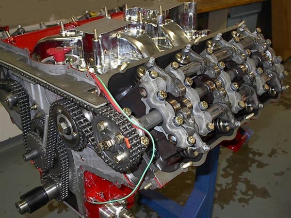

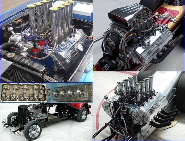

Here are a couple of good articles on the cammer
www.hotrod.com/techarticles/engine/hrdp_0908_ford_427_cammer_build/index.html
www.supermotors.net/articles/lfm-issue01-a2-1.php
http://en.wikipedia.org/wiki/File:Wiki_11_sohc_options_racing.jpg
http://en.wikipedia.org/wiki/File:Wiki_66_SOHC_timing_chain_and_cam.jpg

Got a link to a schematic or somethin similar? Id like to see what the internals look like.
Click on the article links i posted above. The short block has the same components, just switched the cam for an idler shaft that only drives distributor, oil pump, and add a timing gear to drive the cam chain.
They also added an oil drain back hole at the back of the block on each side. These are not needed if you run external oil lines.

What would happen if that chain broke?
Pretty much the same when any timing chain/belt fails, valves stop in the open position and the pistons slam into the valves.

so what made the cammer such a bad mofo? and why cant you get awesome numbers like these out of a Mod engine? pretty much the same thing right?
I'm sure Greg will add to this but with the SOHC you have full hemi heads which give you great breathing and combustion...and then combine that with a high compression ratio and big cubic inch displacement you get a nice recipe for power and torque.

Its basicly a Hemi head on steroids.
If you throw a Whipple/TVS/Kenne Bell blower on a 5.4 DOHC with the right other things you can get 1000+ HP at the crank.
Mike,
Dan & Duncan have you covered. The Hemi heads were the secret, and the reason the engine outperformed the 426 Hemi, was the SOHC allowed for higher rpm's.
Click on the links in my post above that lead to the two articles for more info and pictures.
