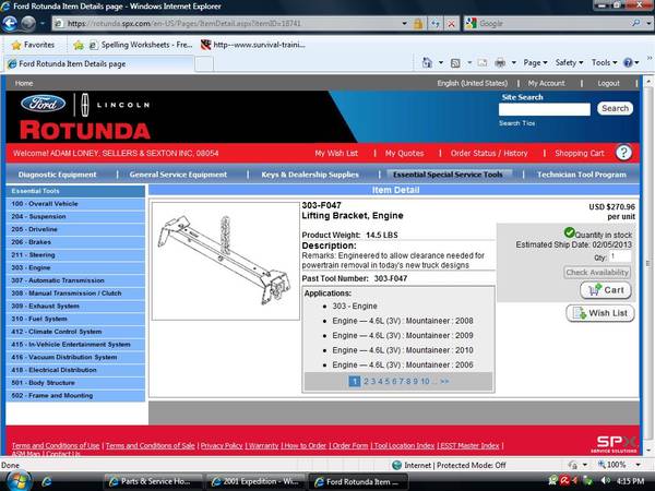

We use a lifting bracket that after intake removal, it bolts to the alternator mounting holes and the two holes in the rear. You can make one with a couple pieces of steel and an old bumper jack.

Thank you. Do you have any pics of that lifting device? Also there is one bolt on the passenger side of the tranny. Any tip on how to get it out. I am it able to get any tools to it. It's the bold just above the starter port.
