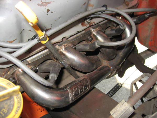

Well, finally got a pair of headers, BBK shorty's
Just need to get gaskets and header bolts, and maybe a reducer?
Not sure if I need the reducer for shorty headers, they are suppose to be a direct replacement fit, but the collector flange is 2 1/4" and the spacing for the bolts is 4" on center. Have to check the factory. Also need to get one longer double threaded bolt for the dip stick bracket.
they came off a 1988 ford truck with a 351 Windsor, but not sure if there is a difference between my '83
nope no difference... how much they set you back?
you shouldnt need a reducer..
Hi Chris, paid the guy $80 dollars. The mounting flange to hook up to the exhaust pipe seems to look wider than the stock flange? And the dome seems bigger too. Really hope that the factory flare in the exhaust pipe will work and the flanges will be the same. Need to go under the truck to check. Wish I kept my old cracked factory manifold so I could compare.
That is a great buy Roy. smilieFordlogo
14,465
385
you got a smoking deal!!!
they should be the same... but doesnt hurt to check and see..
Looks good Roy. They fit nicely.
Thanks Cliff! the headers went on without any problem, one hour tops. The factory manifold bolts all came out really easy! Just ran the truck for a few minutes to heat up the bolts. I need to bring the truck to the muffler shop to hook up the exhaust pipes since the flanges are not the same :( Oh well, not a big deal, looks like I will drive there with open headers!!!!! yes it's loud
