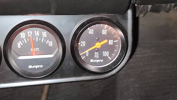

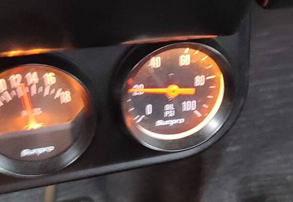

1) Is it too low below for 35-60mph driving pics/video?
2) Is it too low for idel below?
3) He said it may be the oil pump? Is that hard to change?
driving 60 mph:
idle:

Yeah, I wouldn't be running it a whole bunch like that.
Could be other things, but oil pump is a start
Do you hear any ticking or rattling at idle?
Oil pump is rais motor, pull pan, pull pump, replace. Not as easy as I made it sound....

You already have the mechanical gauge, so that would be the test.
Not sure what oil your running. The old girls don't like synthetic. Try some shell Rotella 15w 40 diesel oil in there. Could be lifter issue as well.
I'd probably pull it and freshen it up, being your keeping it forever.
Money well spent. Putting a oil pump on is a temporary fix, even a high pressure high volume. That will buy you some time, but if your losing pressure it has to be going somewhere
