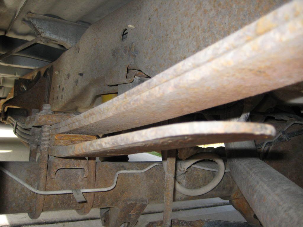

I am going to order a pair of spring packs, front hangers, rear hangers, and shackles. Here's the side that's busted if you're curious of what missouri will do to a pickup...
Okay, so before I order... Everybody make sure I'm not screwing this up.

Whoa! that's some major rust there dude.
You should paint your new springs with some Rust bullet or Chassis saver..
