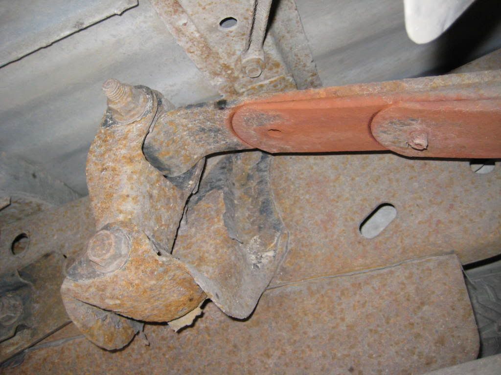

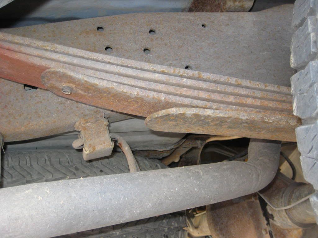

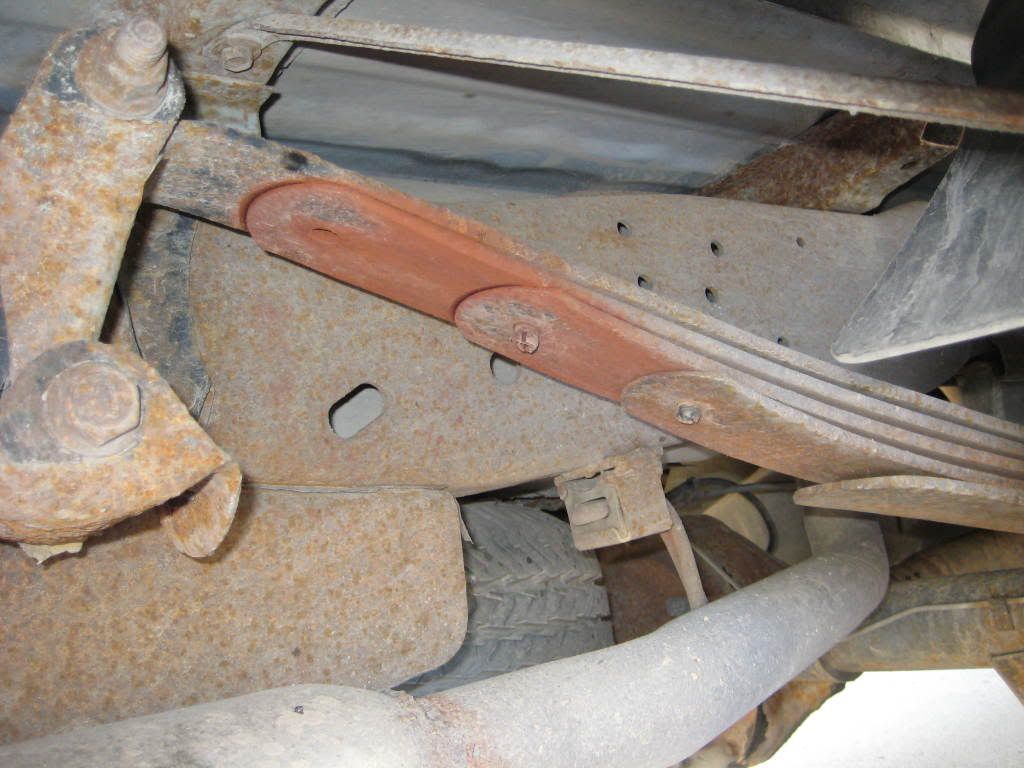

Did I have an add-a-leaf in my pickup or something? I have 5 leaves in my spring pack.
19,083
663
That's what I'm saying is that my bottom leaf isn't tapered off like the rest.
Yeah I was looking at that too... But it has the hole drilled with the separator pad-- which also makes me think it's stock.
Again these are just assumptions-- but they're based MOST of the AALs that I've seen. There's no strict formula.
EDIT: I'm sorry I was looking at my picture :rofl: Nah your bottom leaf could be an AAL... But it would be awfully strange to put an AAL at the bottom of the pack like that... Anything is possible I suppose.
