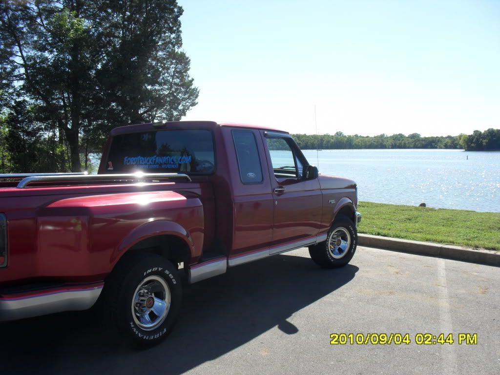

pics for example...
88 F150 2wd w/31x10.5 tires...
92 F150 Flareside 2wd w/ 255/70/15. somewhere in the range of 10.05 in wide and 29 in tall
both together so you can kinda see the difference.
