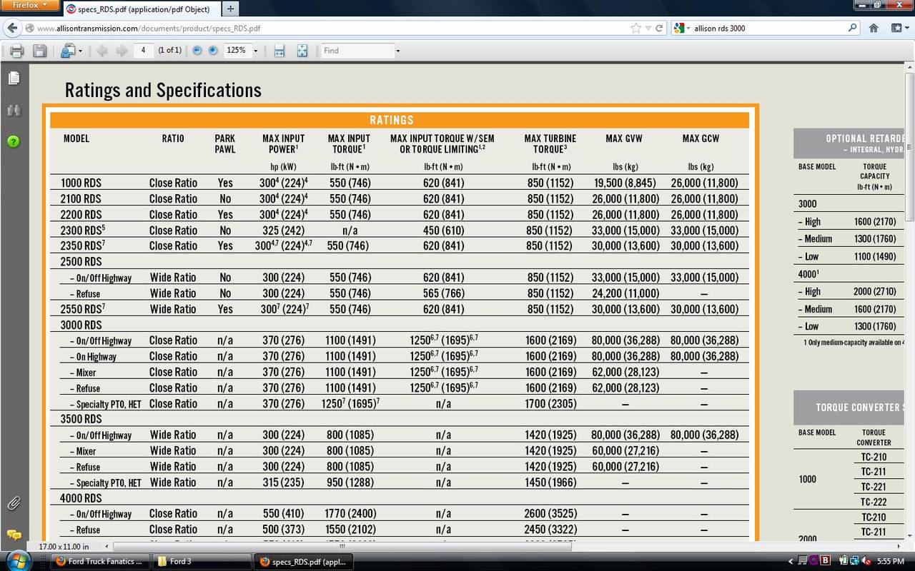

I compare apples to apples...that is a 100% automatic 5 speed
Workin' Rig
Stone Cold Bo Norris
723
7
Hudson MI
Allison RDS3000 with 6th gear programmed out.
