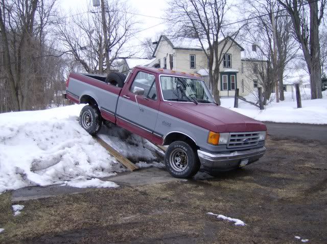

i mounted a piece of c-channel to my bed rail, drilled it to take a piece of threaded rod and it was bullet proof. mine was a shortbox, and i agree Chris...i like the look alot.last pic was before all the work was done.
