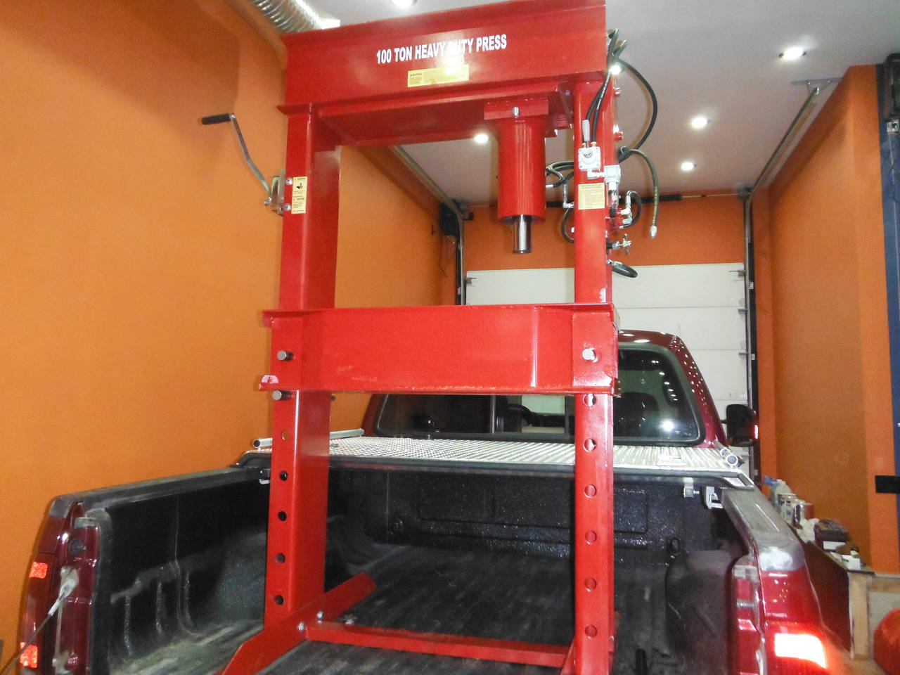

You need one of these Shawn :D
that would have been nice for sure... biggest one i could find around here was 80 ton... but couldnt afford it... that 20 ton has come in handy a few times.. but i hate the notch spacings on it... thinking i need to take a drill to the side posts and make some more notches...
