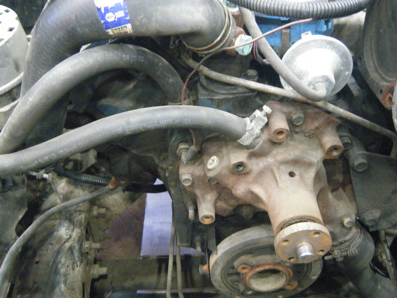

On the 351M/400 there is a dedicated bolt hole for grounding the negative post of the battery to the block. I looked to see if the engine diagram indicated what size bolt was used, but the diagram doesn't show that bolt.
The hole is directly below the alternator at the bottom of the block.
