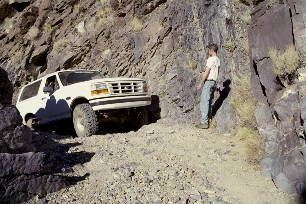

It will be more for parades, picking out Christmas tree, and and occasional trail ride. It has lived to many years to start beating it now.
BEAUTIFUL RIG! I have those same step rails on my Bronco. Would like to see a chrome brush guard also....but I'm a chrome guy by heart! smilieFordlogo
