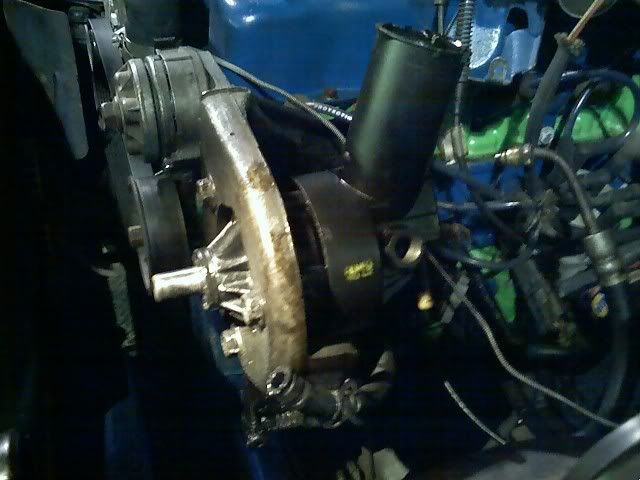

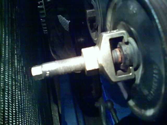

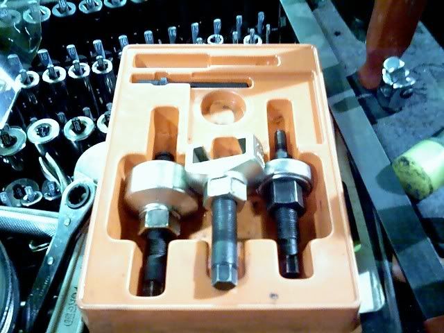

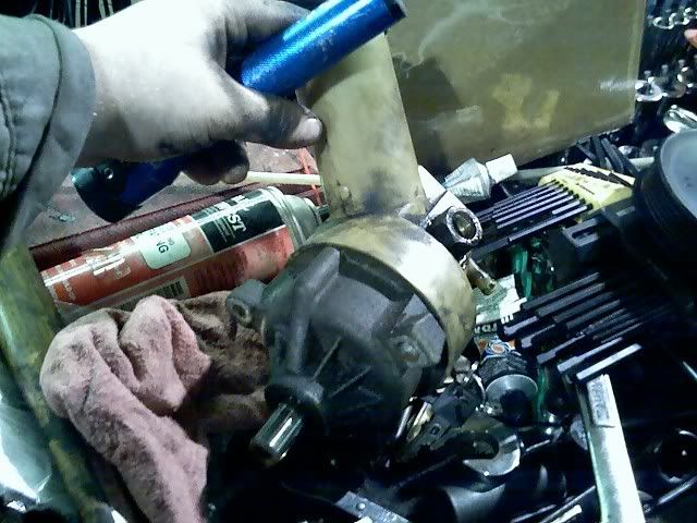

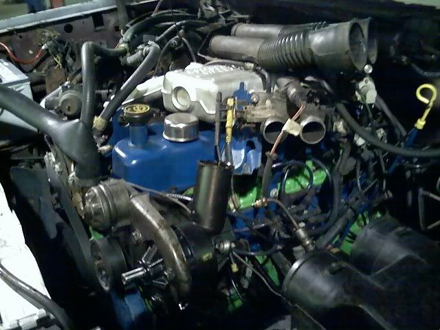

actually i have a few pictures of the proceedure

i didnt have a problem when i did my pump. used the puller and it came off no problem. i used an all metal puller
The pulley? I'm fairly certain that mine is metal... I'm pretty sure if it were plastic then it would have broken LONG before it got pulled off. Hell, the puller tool was made of metal and even THAT was getting destroyed.
YEAH TRAVIS THAT IS NICE...damn
