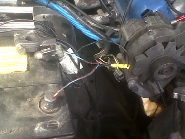

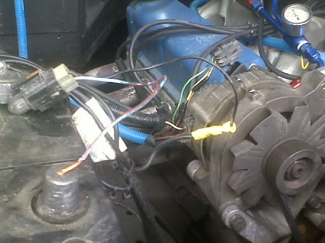

but its the frkn alternator again..it gets hot and drains the battery.. wtf! this is the 2nd one that does this..
Alt fully disconected light turns on ( but i found the prob it was the bazooka subwoofer behind the seat)
that prob is fixed now
alt connected light turns on
alt disconnected light is off
bad alternator right???
