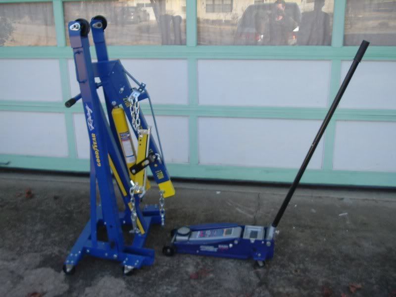

Dad recently bought a big floor jack from the home depot (online-free shipping) for around $150. it goes down to 3.5" and up to 23" I think. Works well, especially on my truck. The straight axle is low in the front, but needs to go pretty high to work on anything under the truck.
I do have a larger one at home, but so far I have not tried it out. It came from Sam's in springfield. They have mixed reviews on hotrodders. The pros who use them every day hate them. The occasional user says they are ok.
Open:
http://i64.photobucket.com/albums/h163/Brian_B_1956/misc/open.jpg
Closed:
http://i64.photobucket.com/albums/h163/Brian_B_1956/misc/closed.jpg
