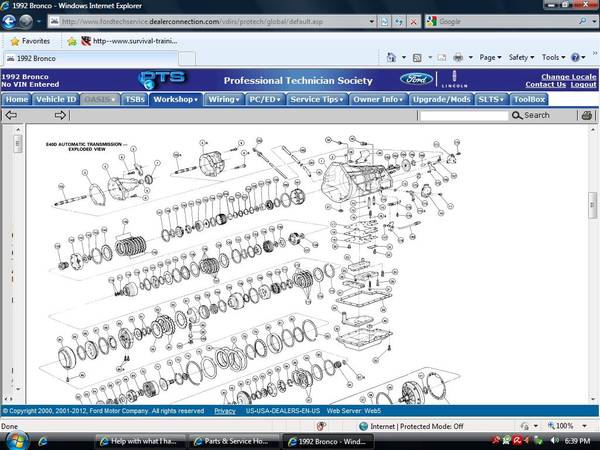

e40d has 19 bolts in the pan
More confusion?
Crap, I thought I was all set, now I'm beginning to wonder again....I just don't want to order the wrong shaft, then lose having the Bronco for another week or two.....maybe I'll call the mechanic and have him measure the shaft for me. It looks like according to Broncograveyard and Rockauto and a few other sites, it comes down to two different shafts depending on the type of transmission and the only difference in the shaft is the length.
Looks like an AODE to me, but maybe I don't have the right view.
It is a E4OD.... I'm telling you
Thanks Chris....I WAS :headbang: 100% sure after I checked the door tag and looked at the dash and arm, but the last few post have put doubt in my mind :headbang:.
Is it possible the rig was modified somehow in the past (like put in a new tranny, or a new motor - 302 to 351?)? Even if it was, it still has to be the E4OD because of the push button overdrive right?
