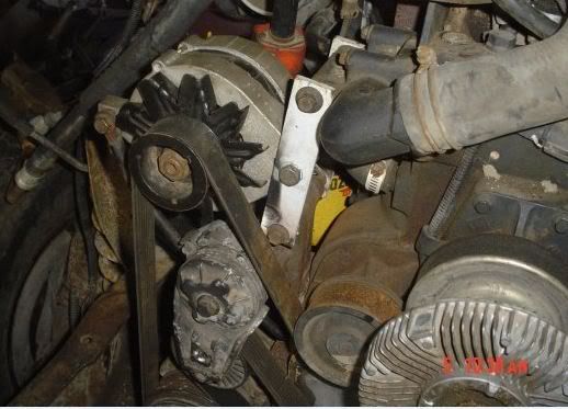

Ok so I just ordered the pollack from jc whitney for 84 bucks it comes with the pigtail. I got another question for ya fellro. How'd you set up the alternator. How'd you do it, did you use the dodge one or your ford one
8,015
393
I used the Ford alt, but there are some that have set up a regulator to run the Dodge unit as well. If you go with the Ford, you have to use the Dodge pulley and a washer to get it to work. the shaft diameter is the same, but the pulley is shallower than the Ford pulley.

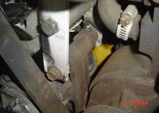

ill probably order some stuff from them so ill ask em about their tach set up ok so i was look at and extra ford alternata i have laying around and was looking at how the alternata mounts to the cummins, it looks like ill have to make a bracket to mount the bottom

Since I broke my drill today. I sat in front of the Cummins in my garage holding the alternata up, thinkin about the bracket you did. And I realized if I rotate it just 180° I could make the dodge bracket work with the ford alt. I do however have to shave just a little bit off the ear of the alt. Ill try to get a pic of it
