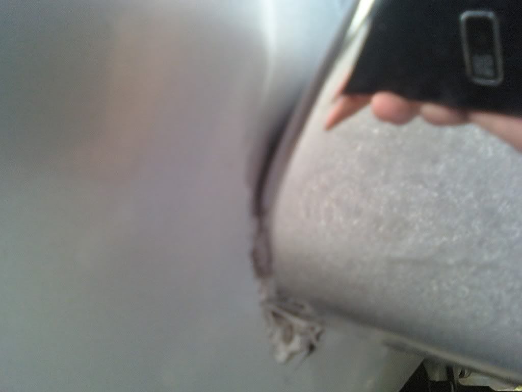

ey has any flareside owners had their fiberglass cracked? i need to repair mine but the local shop wants too much for a 6inch by 6inch repair. 300.00. it looks like a cracked egg shell but still intact. i need to fix it up so i can weld my bumper back on. ? could i just use some bondo? anything let me know.

that makes two of us. repair it with fiberglass? what you mean i can just go out and buy a slab of fiberglass? i never done this kind of work before so....

oh.... but yeah my crack is the back part of the rear drivers step( not the fendor) right behind the bumper. im not trying to make it look factory new but enough to form it back in place so i think ill try an auto parts

If it is cracked you will need to apply a fiber glass mat over the cracked place. Let it harden rhen mix resin and ground fiberglass to create a paste and fill in any indentations let harden and shape to desired shape. then just cover in pure resin a gel coat.Then sand and paint.
