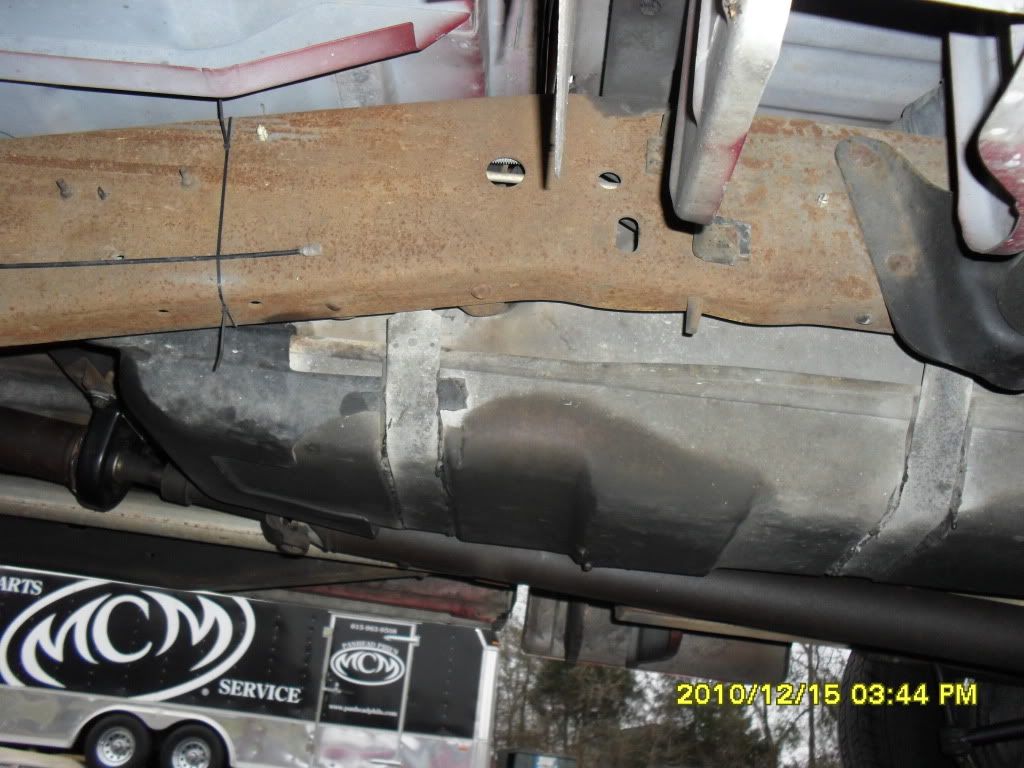

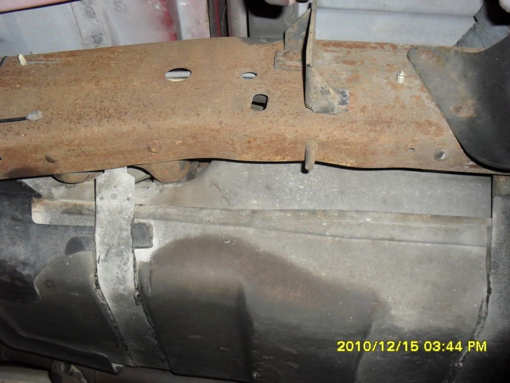

ha thanks for the pic but i should have said under carriage view shots of the tanks position. or maybe if anyone took off the bed. im trying to get a good view on how i should if i could install another tank.
As far as I know, the only truck that can't have a midship tank is a short cab short bed 4x4... That configuration did not have a 2-tank option from the factory presumably because the midship tank conflicted with the transfer case.
The other thing to consider is that youll either need to chop a new hole in the side of your truck or wrap the bed for one with 2 filler doors.
