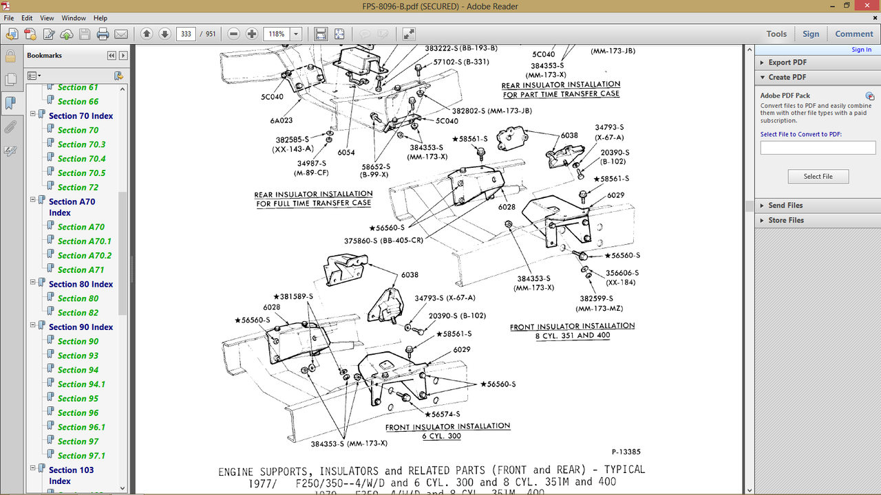

Thanks for diagram
DNFXDLI - I will check it against my workshop manual as well + numbers
I can't find the part number....damn pdf wont open.
Do you have another diagram showing F100 (not 250/350) 4x4 1979 brackets to fit the 300 cu in motor? as the farm is slightly different close to the crossmember…
my workshop diagram shows the brackets to be used are no 5057-G & 5058-L which are different from the bracket numbers in your diagram for a 1977 F250/350 4x4 for 300 cu in… which show 6028 & 6029

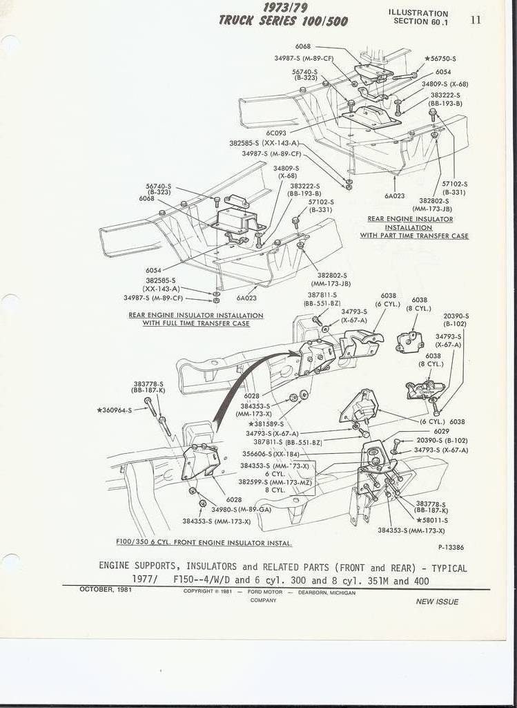

Thanks mate,
The new F100 diagram shows pretty much what i suspected in moving the mounts I have forward to extra set of holes (gaining me about 80mm) of room but Im still short of about 40/50mm. I may have to try to re drill the face of rail these mounts & move the hole forward.

No problem...and it looks to me that there is an extension piece that bolts on to the perch that is mounted to the frame...and then the engine mount goes on that extension piece....I still can't open my other file to see what the part number is though.
I can't see an extension piece in the diagram to be honest - but I do have
engine mounts 6038 (both sides) that bolt to the block & I seem to have the rail mounts (perch mounts) 6028 & 6029… (however as I said couple replies ago - mine a different numbers for some reason…
You're right....my mistake....it must be referring to the actual mount that goes on the engine.
I'm wondering if perhaps the actual brackets that mount to the frame were different being that original engine and an Aussie truck?

Good chance it was different, at least the original mounts likely are. Not sure how much if at all the frame is different.
They look exactly the same (I should try to get a photo to the thread to make it easier) but my workshop manual diagram shows the brackets to be used are no's 5057-G & 5058-L as opposed to 6028 shown in your diagram - altho i suppose numbers can be changed etc
