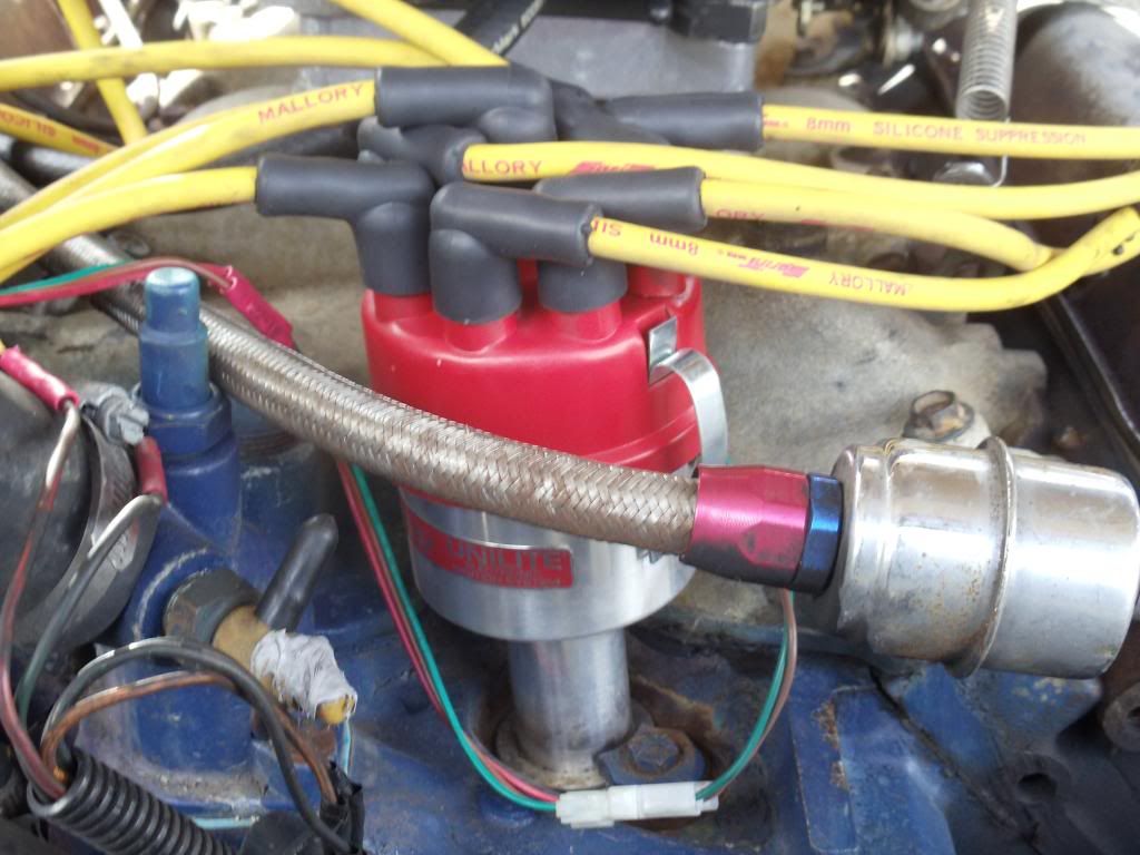

I replaced the factory distributor with a HEI I found on Ebay for about $50. It's a billet housing with GM internals and 1 wire hook up. Sure did clean up the engine compartment and the engine runs better!

Cool, I'm thinking of swapping to HEI. Heard it's a one wire hook-up? Let us know how it goes and could you post a few pic's :wavey:
I'm a little late, but here you go
This one wasn't one wire, it was 3. I had to get a resistor thing and it hooks up to the coil through that and also to the ignition. The engine runs a lot smoother but I kinda liked it better when the truck shook with the way it ran before... Unfortunately my gas mileage seems unaffected, 7.3mpg last time I checked which is pretty rough for a daily driver. I also have symptoms of the timing being off both ways... occasional run-on and slow cranking. So overall probably not worth it, but my old distributor was giving me problems.
