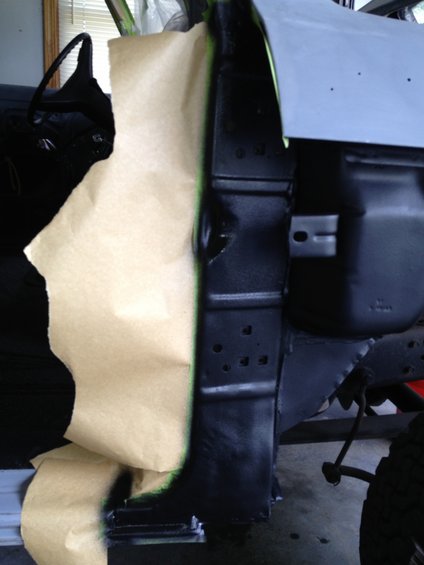

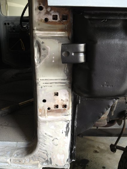

I'm thinking of bed lining the door jamb. I'm thinking of doing the hinge pillar part only and on the inside jamb of the door. The upper side of the jamb will be only paint. I have already done the front section of the lower cowl. What do you guys think?

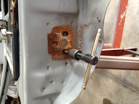

A little help for installing the bolts when rehanging the doors. I've been running a tap through every spot that gets a bolt throughout the whole front clip.

Nope, above the hinges. It shouldn't have any affect on alignment. It is paintable and will be colored over. I took it upon myself to go for it.

Meaning from the inside of the cab? If you look at the picture of the tap in the door hinge bolt you can see the rust build up that was there. From what it looks like the factory put the doors on before any primer or paint hit the cab. Neither side of the hinge mount had any paint. I'm going to do the hinge side of the door as well and I've already done the hinge. After a 12 hour soak in electrolysis it came out real clean. I hit it with some paint stripper and they went to bare metal. Coated with bedliner and they look great. Like Doug said the only one that will know its there is me and the added protection will be a plus.
I've been contemplating doing the lower step of the cab jamb where your shoe always scuffs the paint. This bedliner lays out real nice and I think it would be hardly noticeable once painted.
