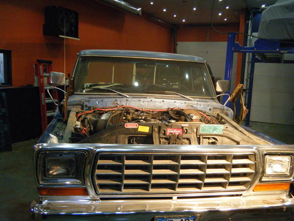

I had big plans to get the engine out this weekend but due to a little episode with my hand it's been put off for a bit. Got the rad drained, hood off and started to remove the fan...that's where I stopped.

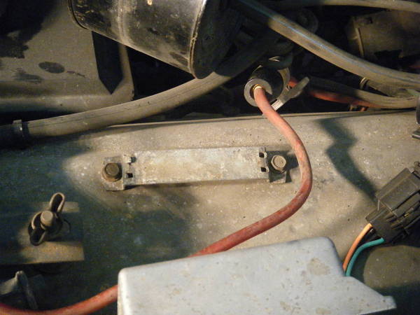

Have any of you guys seen a bracket like this...it was pointed out to me that this is not a stock item yet the bracket is curved to accomodate the vacuum can that you can see at the top of the picture...it looks like there are tabs that at one time held the black coffee can in place but now a tie wrap was doing the job...any thoughts?
Never seen that Bracket before Duncan...the can in the Bronco just has a bracket attached to it with a 1/2" stud at each end that goes through the inner fender and uses a nut for attachment.
Thanks Ben...it looks like a factory item but I don't know anywhere near enough to say.
Looks like a Vacuum can bracket Duncan.
I figured that Tex as the can was zip tied to it but I was told it was not factory but it sure looks like it is.
885
53
It is factory, not a great idea for a bracket but it is factory correct.
Thanks for the info!!...Is it for the cruise control?....It shows one under the fender in my Ford manual but doesn't show the one in the picture I took.
885
53
I'm not sure if it is for the cruise or not. I had thought the cruise can was the one under the inner fender well.
That is what the Ford manual shows...the one under the fender well. One of the tabs has broken off on the can mount in the picture...it will be junkyard search time...hopefully!
That IS a factory bracket for a 78/79 Ford truck Vacuum reservoir
