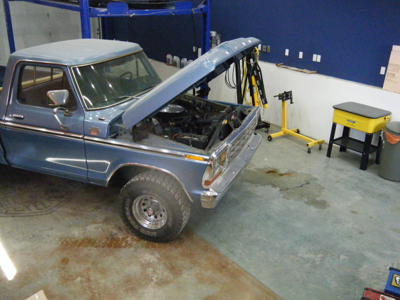

An update.....got the lower garage kinda cleaned up....the truck is moved and ready for the engine to be started on....my help never showed up yesterday so I did not get my compressor moved from one garage to the other. TMI is pretty much paid up so I have to get the block bored to order the right size of piston and then all the parts will be shipped up, although I will have the 4 bolt main caps sent up first so all the machining can be done at once. The engine will be TMI's 434 with the CHI 3V heads and intake, roller cam and rockers and the CR will be about 12.2:1. TMI figures it will be in the 575 or better TQ and HP. As you can see in the pcture it is leaking all kinds of stuff...it hasn't moved in nearly a year.
Nice truck, what is the comination that makes a 434 ?
4.25 inch stroke by 4.02 bore....so actually 431.5......or 435.8 if a 4.04 bore....stoker motor should develop over 400lb ft TQ at 2000 rpm.
Minor update....heads are being cc'd and then pistons are being machined. Final CR is going to be 11-11.5:1 down from the original plan. TMI has some valves on BO but is going to try and ship everything be the end of Sept. My lazy azz still hasn't pulled the motor yet.
