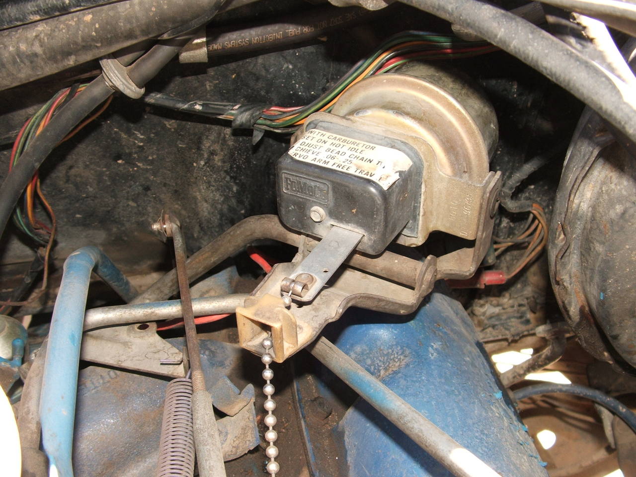

One of the members requested some pics of the cruise control setup, so I decided to post them here.

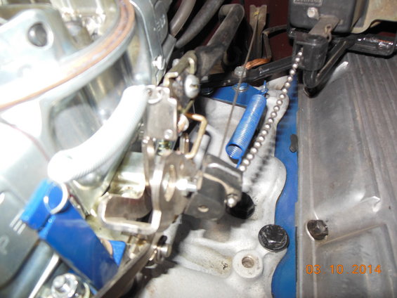

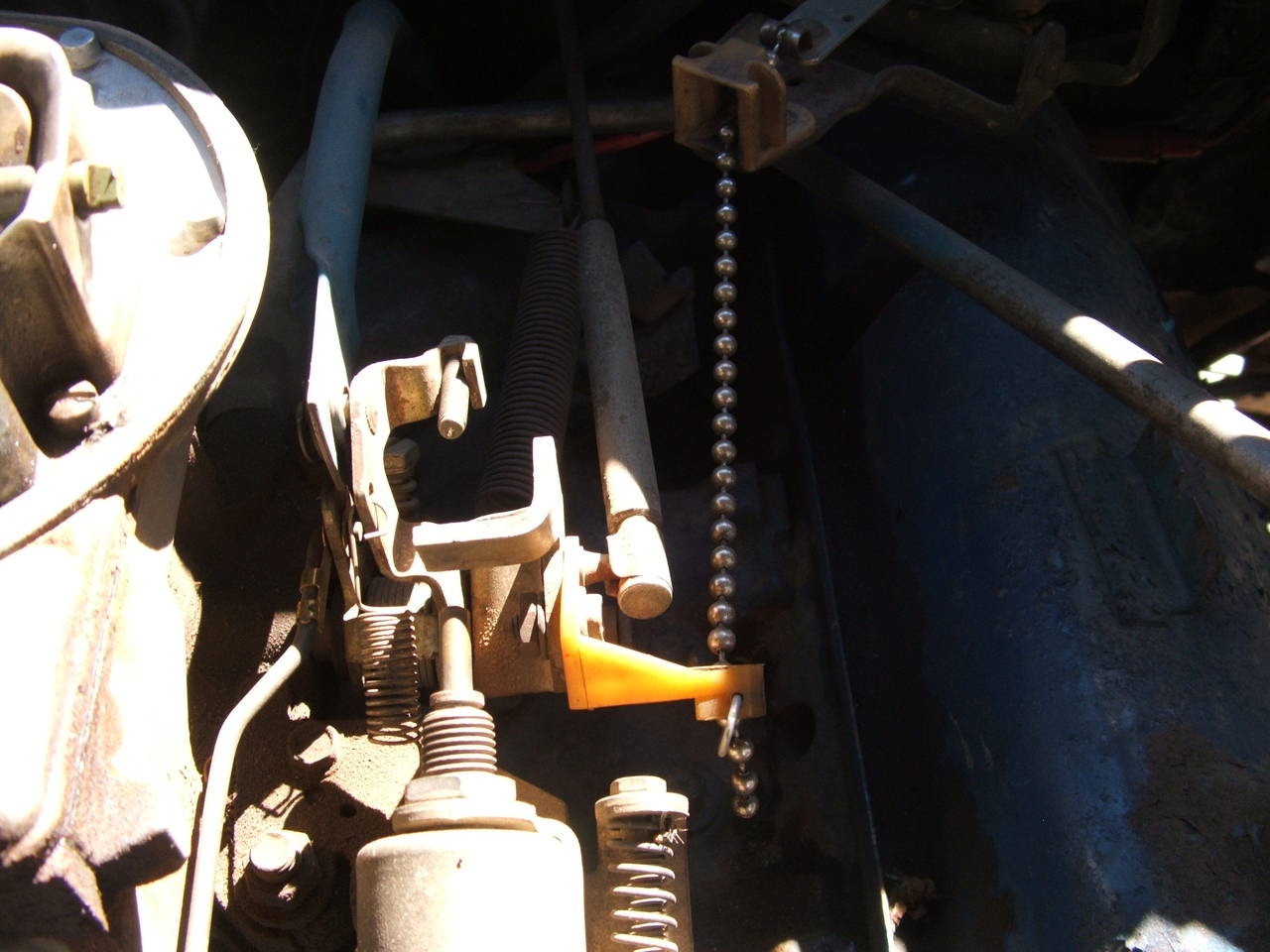

The first picture is the bakelite connection for the cruise control chain to the carb.

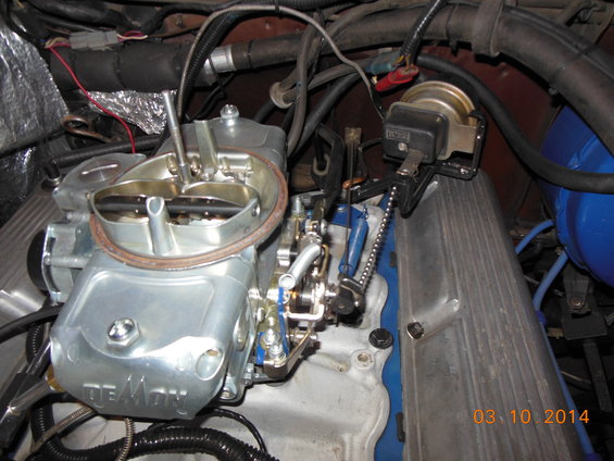

The second picture is the servo mounted to the intake manifold. There are two sets of wires that come out oif the back of the servo and go into the cab.

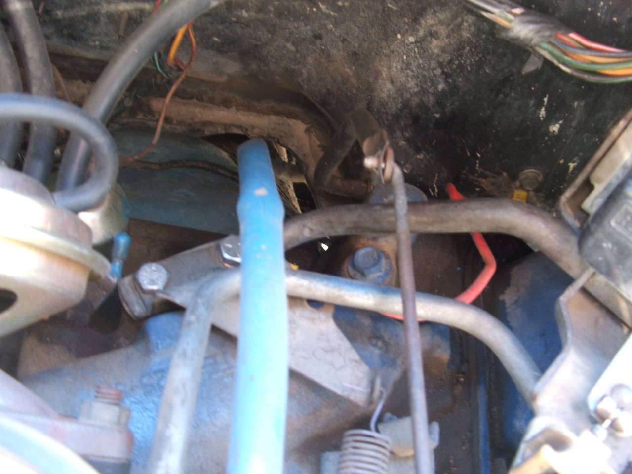

The third picture is the mounting point for the servo on the intake manifold.

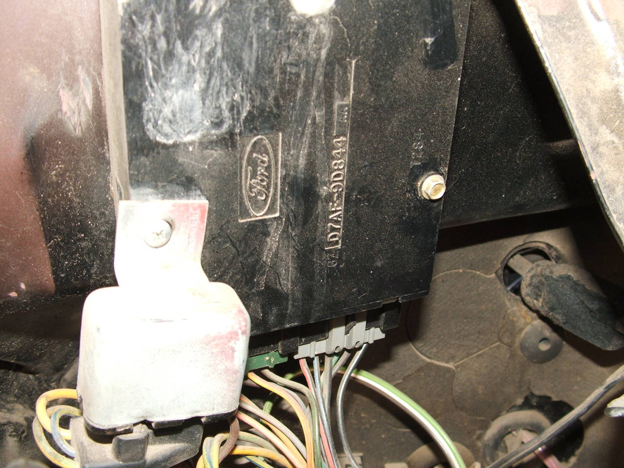

The fourth picture is the amplifier mounted behind the gauge cluster.

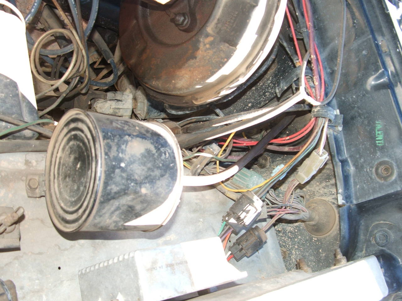

The fifth picture is the second vacuum canister. I don't know if this is just for the cruise or not.

Thanks for posting those pics. From what I see, it looks like I have everything intact on my 75 supercab. The only thing I don't have is a steering wheel with cruise. I found that odd when I bought it. It has a year correct steering wheel, but the center pad is a non-cruise one. So, I don't even know if the cruise works.
So, that small vac cannister is for the cruise huh? Is the other cannister the large one that mounts under the driver's side inner fender?
After looking at that canister a little closer, it looks like BOTH canisters are tied together via a vacuum tee to the left of the brake booster on the firewall. I'm guessing it is just additional vacuum to run whatever needs to be run.

Buck, the picture of the servo shows the vacuum splitter just to the left of the servo on the firewall. The bottom line comes from the vacuum tree on the back of the engine, and I think the other two lines go to both vacuum canisters.
Thanks a ton Doug...I can look at diagrams and schematics all day long, but something gets lost in translation to real world physical parts for me.
I will share a couple photos of my setup which is for a 79 which uses a cable throttle instead of the solid linkage.
I originally had a 351m and swapped for a 460. My truck had factory cruise control originally and was not swapped in. I used a servo bracket from a 77 Lincoln Mark IV with a 460 and noticed that the 460 servo has a slightly longer chain than the one on a 351m. The original 351m servo chain would not reach. I am using a road demon 725 carb.
The cruise vacuum is sourced from the engine tree which tees in with the canister under the fender via the disc shaped tee in my last pic. The canister on top of the fender apron is tied in with the hvac controls in the cab.
