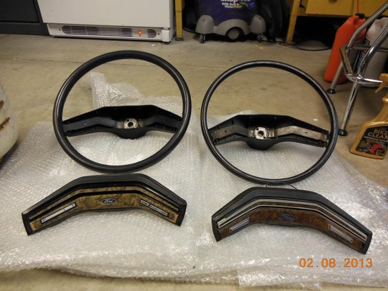

The 78/79 wheel pads with cruise are difficult to find in decent condition they are usually sun faded and broken on the sides. As I understand it they are not being reproduced yet. NOS pads are outrageously high priced. I found an 85/86 ford lariat wheel with the thicker padded grip and cruise pad. I was going to use my 78/79 pad on it but in the swap process somebody knocked the wheel off the shelf and destroyed it. So I have the 85/86 pad. The wood grain is not an exact match but its close enough for me and it seems to be built better where the older ones fall apart. It does have the extra resume button which does not work but everything else works fine.

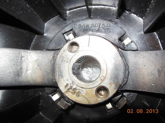

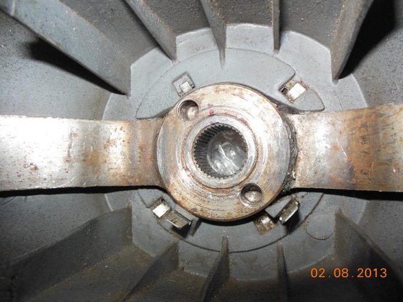

I have heard there are wheels out there that have the right splines but I couldn't find one so I modified it. The whole point is that the newer wheels have a thicker grip and are easier to find. I got mine on ebay for around $50 but they are typically higher.
original 79 wheel
newer wheel with flat spot ground out with dremel tool.
