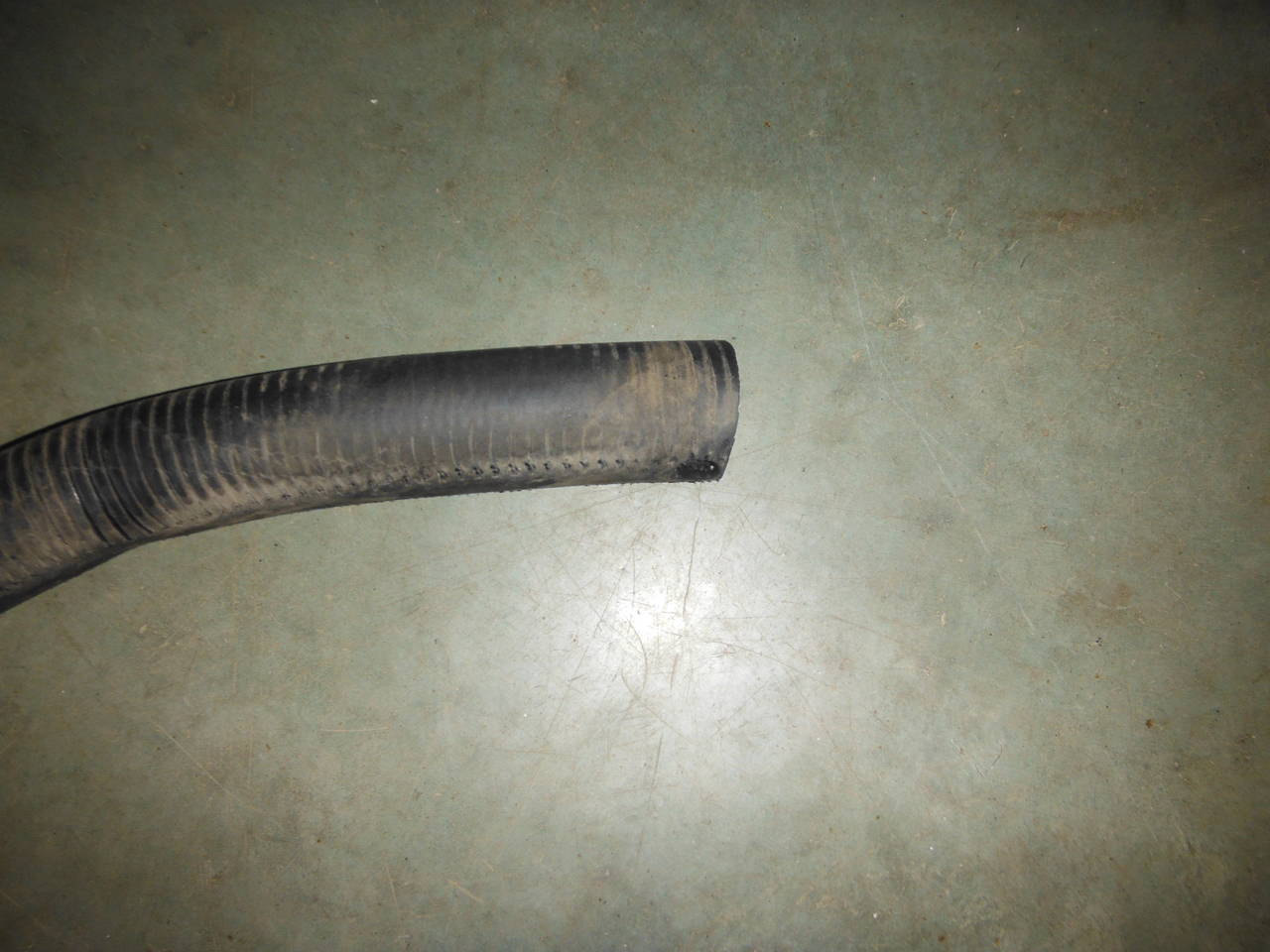

As I got out of the truck last night when I got home...I've been checking my coolant as I seem to have a slight leak....more on that later....I see a little patch on the ground...uh-oh.

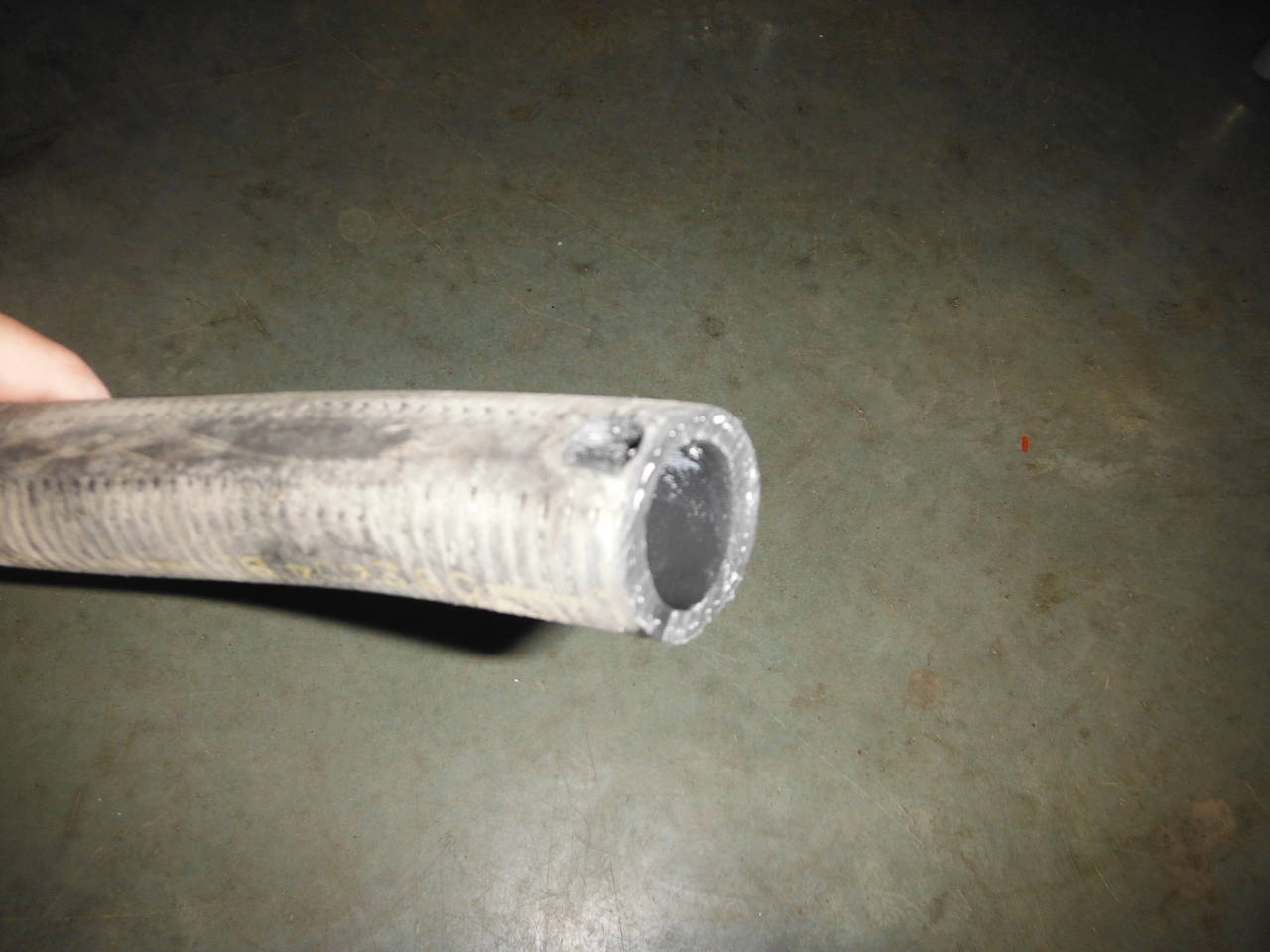

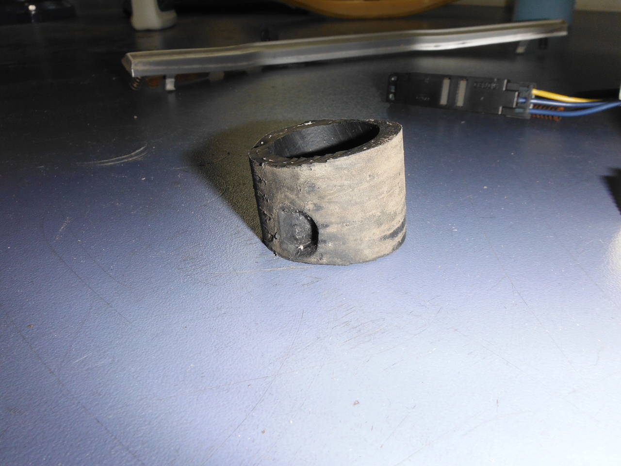

Upon further investigation, it seems that the 5 foot long, formed hose from the coolant bottle to the water pump has been rubbing on a bolt since new and finally produced a pinhole leak.
Am I ever happy it got me home!
New hose ordered....7 day delivery so for now I'm going to pick up a barbed coupling and do a temp repair.

Temporary fix done, I'll take a closeup pic of the damaged section...pretty damn amazed that it didn't let go long before now.

Here is a pic of where the end of the bolt was rubbing...pretty amazing it took 8 years to finally go through:
