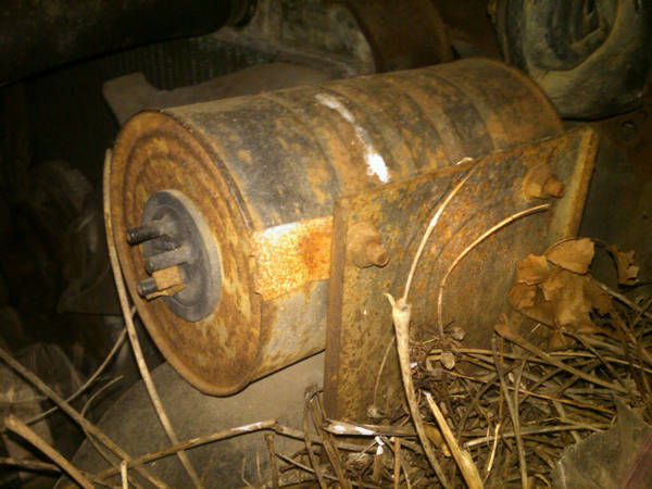

Hey fellas. I'm trying to find a replacement for the coffee can vacuum reservoir that mounts on the driver's side inner fender. Problem is, the one I current have only has one port, all the good ones I'm finding have 3 ports. So what's the difference and/or where should I hook up my vacuum line? Are they even compatible? Here's a pic of one with three ports:

Dennis...the pics you posted looks like that can goes to the smog pump, I no longer have the smog pump. I'll take some pics and see if I can't figure out where it's routed to. I thought it was a reservoir for the A/C and HVAC controls.
Ben , how big is the hole thats rusted. Can it be patched with a liquid rubber poured inside it.? Sort of like por 15 gas tank sealer.
I'm thinking cheap like rubber dip for tool handles .
I was thinking something along those lines as well. I was thinking the JB putty might be the perfect candidate. The gash is about 2.5-3" long and about 1/8" wide.
Use one of the holes and plug the other two? I might have one of those 3 port ones if you're interested. Though, I might need it with my big new cam hehehe
If my reading is correct, I'm starting to think the three ports are for smog/emissions stuff and the single port is for dash controls. And I was getting the two confused. Thanks for the offer, I'll do a little more digging and see if I can't figure this out.

Since the can you have is already wasted, why not cut it and see what's inside?
I don't see how there could be any difference as to what goes on what nipple....it's just a reservoir. You should be able to use a three-nip and just plug the other two.
Nope, those hoses go to the Vacuum amplifier and manifold vacuum line

All the reservoir is for is to ensure the AC and speed control have enough vacuum to operate properly.
The power brakes may need it as well.
:rotz: (sigh) And the year is? There is more than one of these puppies. I'm assuming it's not for the 1996.
DODZ19A566A .. Vacuum Cannister / Obsolete
Fits: 1973/75 F100/350 w/factory installed Integral A/C / 1970/72 Maverick/Comet.
No Ford Dealer or obsolete parts vendor has any.
D6TZ19A566A .. Vacuum Cannister / Obsolete
Fits: 1976/77 F100/350 / 1978 F100/350 & Bronco before serial number AJ0,001 / 1973 Maverick/Comet/Pinto/Bobcat.
GREEN SALES CO. in Cincinnati OH has ONE = 800-543-4959.
No other Ford Dealer or obsolete parts vendor has any.
D7OZ19A566A .. Vacuum Cannister / Obsolete
Fits: 1978 F100/350 & Bronco from serial number AJ0,001 / 1979 F100/350 & Bronco.
Fits: 1977/79 LTD II/Ranchero/Cougar/Thunderbird/Mark V without A.T.C. (Automatic Temperature Control) before production date 2/1/1979.

Sorry about that Bill, I had mentioned it in a couple other threads, and just assumed folks would know what I was talking about, but we know where assuming gets us. Anyway, it's one of my pet peeves as well. It's for the 79 Bronco.
