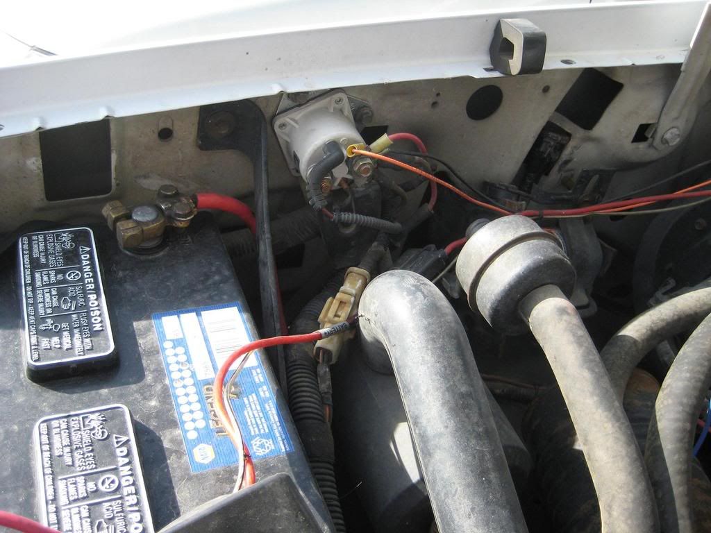

I have a few 'extra' wires for my own purposes, but you can at least see where the stock ones fit.
Yea thats how I have it. Caus I looked on my truck to be sure, but the bronk has alot more then the truck. So 1 side is battery, and the other goes to the starter. What the heck, ill have to pull the wire off the starter and clean that up and see if it makes a difference. I shouldnt have messed with it.

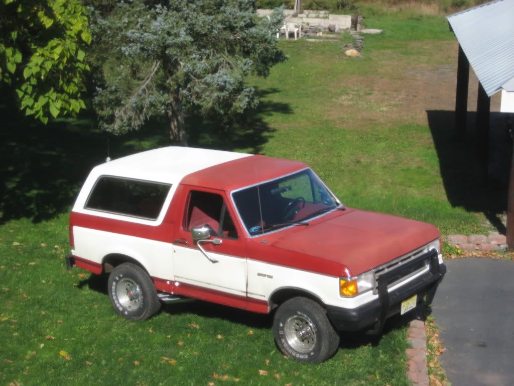

So here are some pics of the bronk with the exhaust finished.

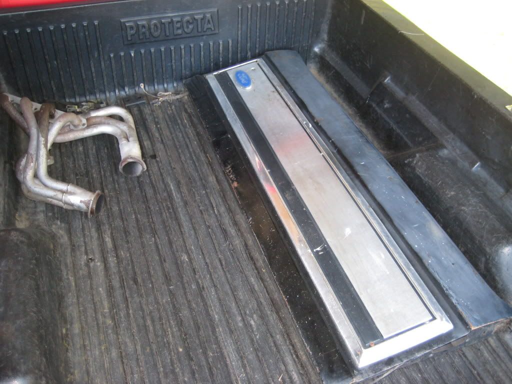

On another note I picked some parts up for it yesteday, long tubes, starter, alt, tailgate and glass for it. 200 bucks.

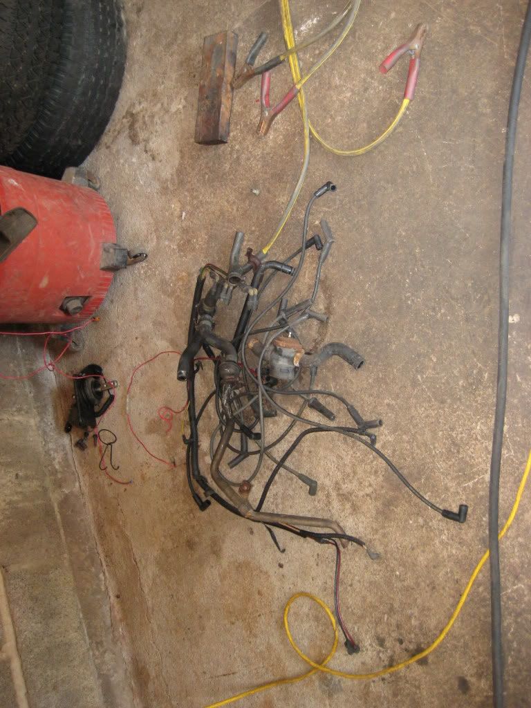

Also Pile of emisions stuff.

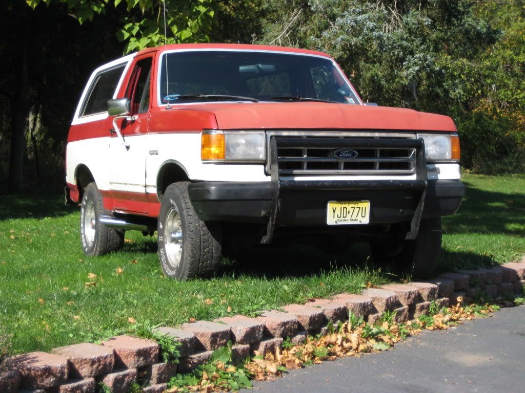

hey nice push bumper! looks to be exactly like mine. glad to hear the starting issue is resolved
Yea came on the truck lol. I got to do some body work on this thing. Its super crappy lookin in pics.
