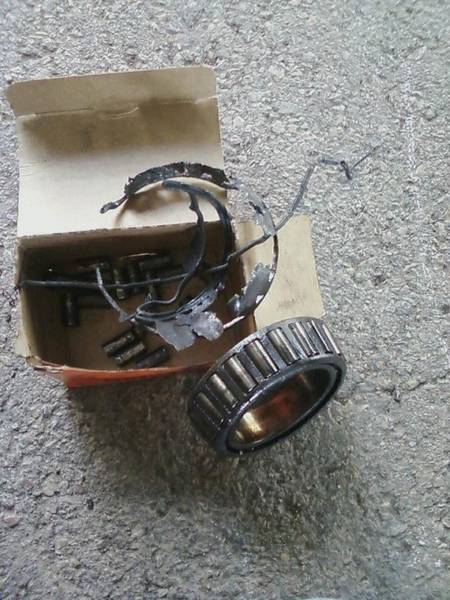

Anyway, decided to finally tackle the rear brakes on the Beast and I knew I'd find the metal to metal noise culprit back there but wasn't expecting to see an exploded bearing with a broken race and spindle nut grinding its way into my axle shaft hub...
She's all cleaned up but yeah the inner race bore out my hub and the new race just bounces around in there. I need a new hub. Guess what? The local parts stores are only good for air fresheners and fuzzy dice. They only have the drum part...no hub. WTF?! So I've got an A.P.B out at the salvage yards online, and notified my buddy back home to send me one if it comes down to it, but I'm in a race against time as I'm moving this weekend and really dont want to leave my ol' girl behind while I'm waiting on a part.

The culprit...
Where did all the grease go ?
The culprit...
Probably burned up when all the bearings started biting into the race...the race is split open too. I'm thinking whoever put that wheel back on didn't pack the bearings properly and/or didn't get that wheel back on the spindle right.
