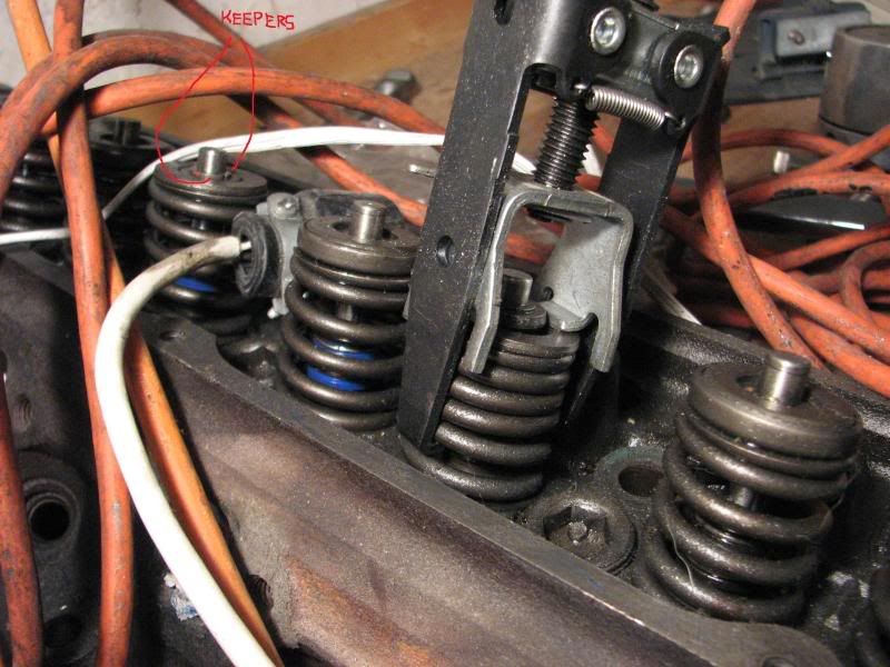

Heres the pics man.
So to change them with out taking the heads off... You remove the rockers. Then you get that valve spring compressor tool and make sure the piston is at top dead center.
Then use the tool to compress the valve spring so you can remove the 2 valve spring keepers. These lock the valve spring onto valve. You have to compress the valve about 1/2" todo so. The valve keepers can be a bit tricky to remove but using a pick or hitting them lighty with a flat head can set them free.
Then once there free remove the spring and you will have access to the valve seals. These just pull off with a set of pliers. And install is the reverse.
You can see here how I am (was lol, ill finish it evenchually) changing my valve seals. The blue ones are the new ones. Black ones are the old.
This is one of the 2 keepers that each valve spring has. Dont loose them, there pritty easy to loose.
